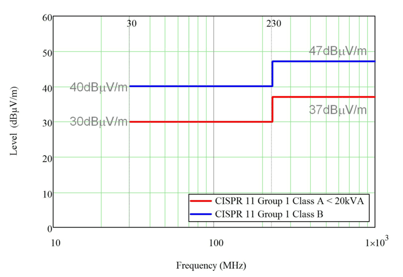

We are required in pretty much all countries to comply with one of two levels of EMI -- Level A or Level B. They are about 10dB apart. Level A is for industrial/commercial settings, and Level B is for residential settings.
The EM radiation levels are generally measured in the far field at 3m or 10m depending on the standard. The goal of the EMI regulations is to prevent interference with radio receivers that are practical distances away, not held up to the equipment. If you ever experience EMI stepping on your radio receiver you need to contact the FCC to have them find out who is causing the harmful interference. It is then up to the source of the EMI to fix the problem. If the source of the interference is not obvious, I may be one of the folks called into hunt down the source. :smile:
[Update -- I just noticed that they seem to have gotten the red/blue colors reversed in the graph below. Level B is more restrictive than Level A, so the colors should be reversed]
https://e2e.ti.com/blogs_/b/powerhouse/posts/a-review-of-emi-standards-part-2-radiated-emissions
