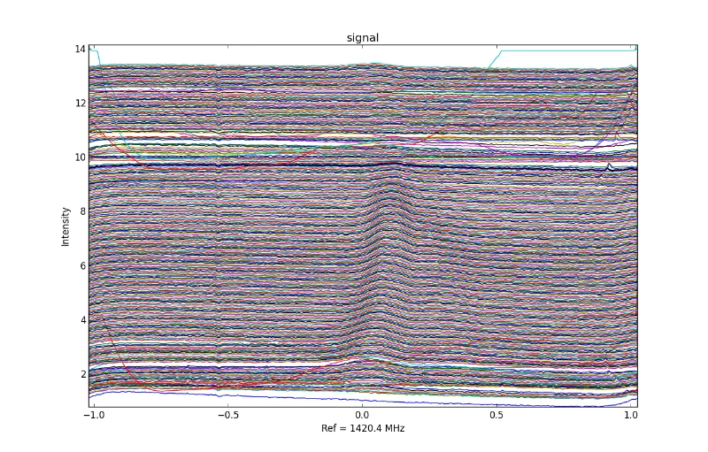

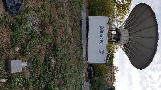

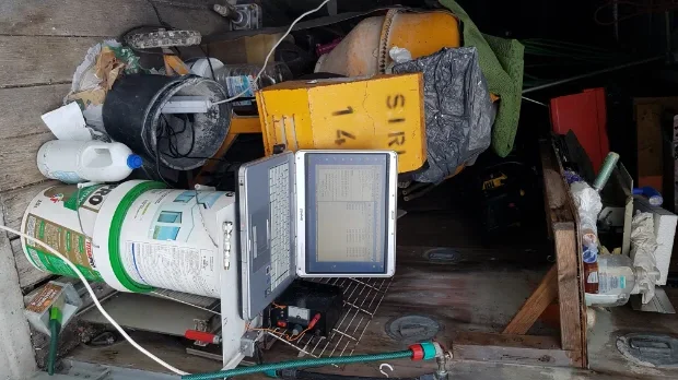

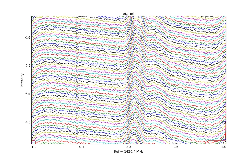

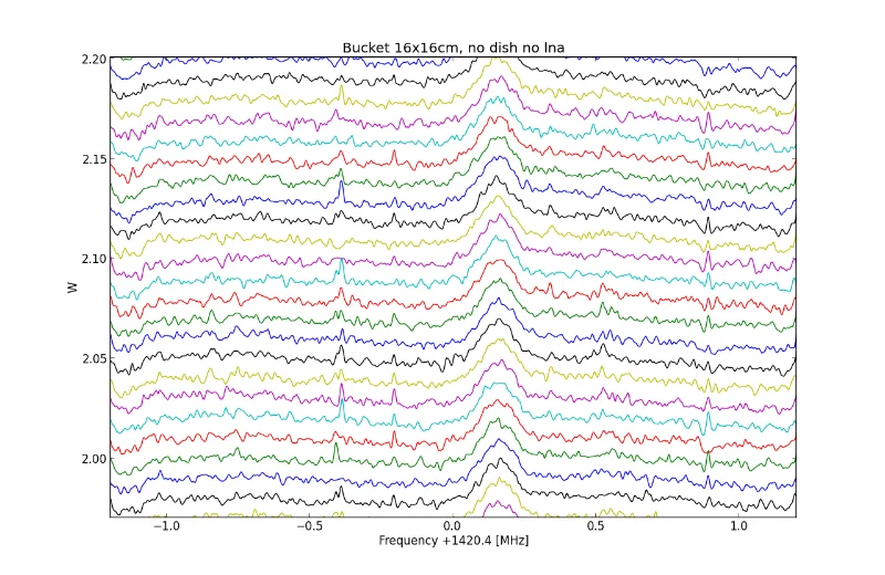

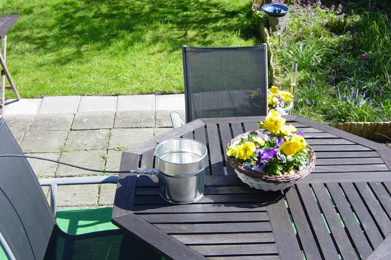

The 21cm hydrogen line may seem dull to some but the data collected with this antenna looks nice.
https://16767887561855875192.google...4KkP3VIrWM-hyjb60s4fTizyPxL-6alSQSNOSTjUb1Nns

Wow!Paul Colby said:The 21cm hydrogen line may seem dull to some but the data collected with this antenna looks nice.

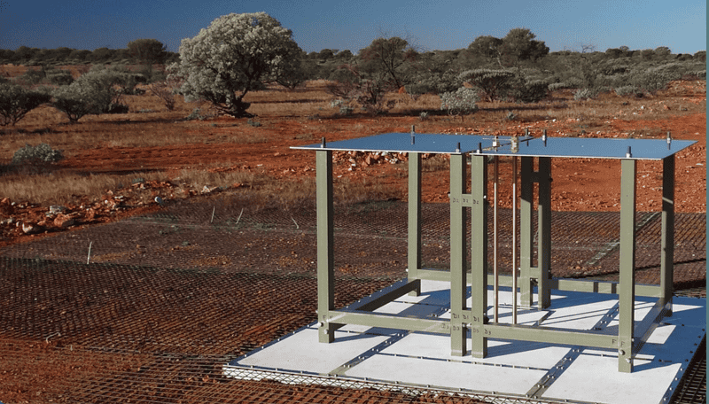

That is one experimental antenna element being evaluated. I believe there will be two in the array, separated by 150 metres. That makes it an interferometer for low-band VHF. While the elements are low-profile, the array is ten times larger than a 15-metre dish.ohwilleke said:So, if you live in the middle of nowhere, this can work. If you live in the East Village of Manhattan, on the other hand, don't bother. The local radio background noise will dwarf anything interesting you can pick up from space aside from the Sun.

I found this forum and clicked on the item.
I was sad to see that some people were so negative about receiving radio astronomy signals.
See below picture of a minimal bucket antenna in the backyard of a house in a city in the Netherlands.
Also a result plot is given.
This can also be a setup for a school project.
I do not know if it is allowed to post links, so I wait and see
2025 Award
- 17,252
- 10,712
Welcome to PF.
Yes, you can post links.

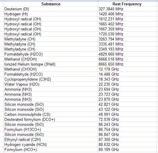

Here is a (short) list of maser frequencies which can be persued to probe the forming and death of stars (and the forging of the elements we are made of).
You can see that the lower frequencies are also possible to capture with a standard low cost SDR.
more info on
more info on
