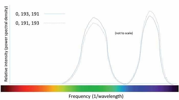

collinsmark said:
Your diagrams are incorrect, when applied to an RGB monitor. You have put two green wavelength peaks (A and B) in your diagrams. And RGB monitor is not capable of producing color peaks so close together. An RGB monitor produces one, and only one, peak of green wavelength.
You're misinterpreting the diagram. I debated how much detail to put in before it got confusing.
Those vertical lines are not narrow light frequencies, they are combined display colours. They are (for argument's sake) RGB 0,193,191 and 0, 191, 193. A monitor is certainly capable of displaying them.
"Combined dispaly" colours? I'm not sure what that means. Perhaps we are talking past each other due to a misunderstanding of how an RGB monitor works.
Below is a more qualitative (not to scale) way of how an RGB monitor produces the colors RGB [0,193, 191] and [0, 191, 193]. Does it make sense now how this is not an adequate tool to use for a tetrachromacy test?
Notice that after combining (neglecting any slight overlap, which I think is a valid approach, given the narrower, primary color bandwidths produced by the monitor), the individual peaks do not change frequency (reciprocal of wavelength), at least not significantly. They only change their relative intensities.
I'm saying the diagram is not depicting two narrow frequencies of light; it is depicting two colours (i.e. 0,191,193 and 0,193,191).
No. I know how they work. Being in both software/.hardware as well as photography, I have a better thna average understanding.
Perhaps this is a place where we can meet. As I said before, it is certainly not ideal to use RGB monitors for study, I was simply making the point that a tetrachromat could distinguish colours better than a typical person, even when looking at a monitor.View attachment 84305
Notice that after combining (neglecting any slight overlap, which I think is a valid approach, given the narrower, primary color bandwidths produced by the monitor), the individual peaks do not change frequency (reciprocal of wavelength), at least not significantly. They only change their relative intensities.[/QUOTE]
Correct. And a tetrachromat will be able to perceive them better.
I'm annoyed, I should have just done the diagram accurately, and damn the information overload.

But scientific tests should be able do it. Perhaps paint swatches with two different, yet metemer pigments, both with equal texture and gloss and such -- pigments with different spectral properties, yet indistinguishable to most humans. The lighting needs to be controlled too. The ambient light fixtures must have proper spectral properties (perhaps direct sunlight might be a better option).
Maybe a better test is one that is more direct. Perhaps creating two color metemers with combinations different hot gasses, each gas bulb producing very narrow spectral lines. The test would then be looking at a matte, white surface reflecting the two different light combinations. Of course one of the light combinations would of course have peaks in between the standard RGB primary colors, and the other not so.
A simpler version might be like the gas bulb test, but instead simply using different combinations of narrowband light filters, filtering sunlight. (Such filters might be constructed for use in photography or astrophotography. [but probably not for color photography])
If she could reliably and repeatably distinguish the two pigments or two light combinations, when most other people cannot, that would be evidence of tetrachomacy.
[Edit: Or lasers! Anything involving lasers is cool. For example, use a yellow laser together with a micro-mirror device to produce an image. Then use red and green lasers together with the micro-mirror device to produce a metemer image (after adjusting the brightness, and red/green color balance).]
Concetta Antico was apparently tested with a sort of "minimum motion" test where different colors were flickered at a varied rate on a background with particular spectral properties (the minimum motion reference comes from how humans can perceive motion from still pictures displayed in quick succession, such as in a motion picture). I can only seem to find the preliminary results of the test (I wish I could find something which describes the test in more detail, but alas, my googling skills are sub-par as of late [Edit: found something. See next post]). Here's a link to the preliminary results (from her website): http://concettaantico.com/?smd_process_download=1&download_id=2054
