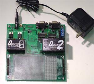

I did use a few of these in 1990's for very specific tasks that had to be automated:
http://micromint.com/Modules/domino.html
Photo of a green Domino development board with two DB9 serial ports, a DC power jack, a wall power adapter plugged in, a prototyping grid area, and a small Domino module labeled Domino 2.
They offered the benefits of:
your office PC is your development system,
they have standard I/O ports and I^2C, and real time clock
there's room on the development board for your I/O circuitry
and they program in Basic;
So you can do a small project on petty cash.
Once upon a time we needed a crane interface and couldn't get a quote from anybody with less than five zeroes in the price. We did it ourselves over a weekend for about $400. Was boss ever happy ! [oops another boring anecdote - never again !]
Photo of a green prototyping board with a DB9 serial port, a power jack, a wall plug-in power adapter, and two Domino 2 modules mounted on it, with a perforated breadboard area below.
Nowadays TI has caught on and offers similar products (finally!)
