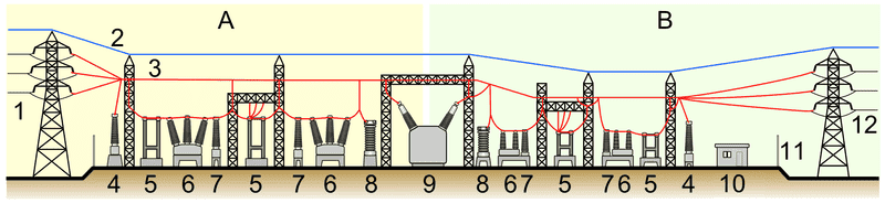

Look carefully and see if your MGN doesn't go at least to the structure(usually galvanized steel) holding the first insulators of the distribution lines.
When you build a substation the first thing you do is dig way down and lay a crosshatch mat of big wire mesh. That establishes a ground plane for the substation. Then you fill to level of substation grade. All structural steel is tied to that mat by big conductors that are usually not insulated, they look innocuous and simply disappear down into the fill. So the MGN need only be tied to the galvanized steel tower that holds the insulators for the phase lines. That steel is tied to the mat underneath everything. Next time you're around a substation look at the feet of the towers for that bare "earthing" wire.
One purpose of the ground mat is to limit the voltage drop along the Earth should a fault occur, such as a wire falling to earth. They want the volts per meter along ground to be low. A walking man's two feet span roughly a meter and they want the voltage between his feet under fault conditions to be insufficient to electrocute him.
Of course it also provides a substantial surface area for dissipating lightbing harmlessly well below substation equipment. The whole substation "rides" the potential gradient like a magic carrpet.

I checked a couple of substations and did find that the neutral wire went underground with the power lines. I assume that it connected to the ground mat that you mentioned.
It's definitely making more sense now. As far as my neighborhood is concerned, there are only two of the phases tapped, each for about 30 homes.
Someday you'll see a substation crew there. Ask them for an introduction to the layout and about where that neutral goes. A utility crew showed me which breaker fed my neighborhood.
