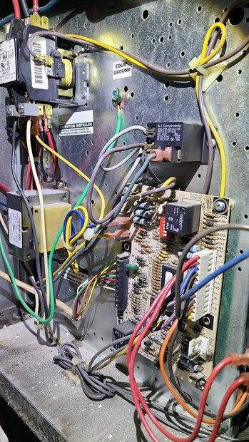

I just looked at the manual for the controller. The cover photo of the controller shows two Molex connectors, those white ones along the top edge of the board.
Those Molex connectors are infamous for corrosion/oxidation that causes intermittent connections!

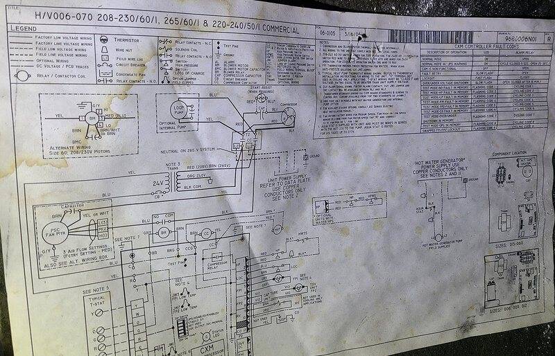

Photos of the controller/xfmr and wiring diagram, if these help.
Photo of an HVAC control panel interior with a contactor at top left, a 'Equipment Ground' label, a circuit board with relays and plug connectors at right, and a dense bundle of colored wires.
That circuit shows TRANS (note 3), the 24 V secondary transformer with;
Black com 0V, Orange 240V, Red 208V, and Brn 265V.
But it appears they have confused or swapped the tap positions.
In what way, exactly, does it look confused? It's tough to see in that photo, but it's the red wire connected to incoming power that goes to the transformer. That's correct; 208V. The tied-off wire (covered with electrical tape) is the orange wire. I don't see a brown wire.
Or are you just saying the diagram looks wrong? I don't think that should matter.
The primary and secondary should both have the same volts per turn. But the 208 V tap is at the far end of the primary winding, while the 240 V tap is part way along. That is backwards.
I would check that the windings were correctly terminated, by measuring the voltage on the other available taps.
