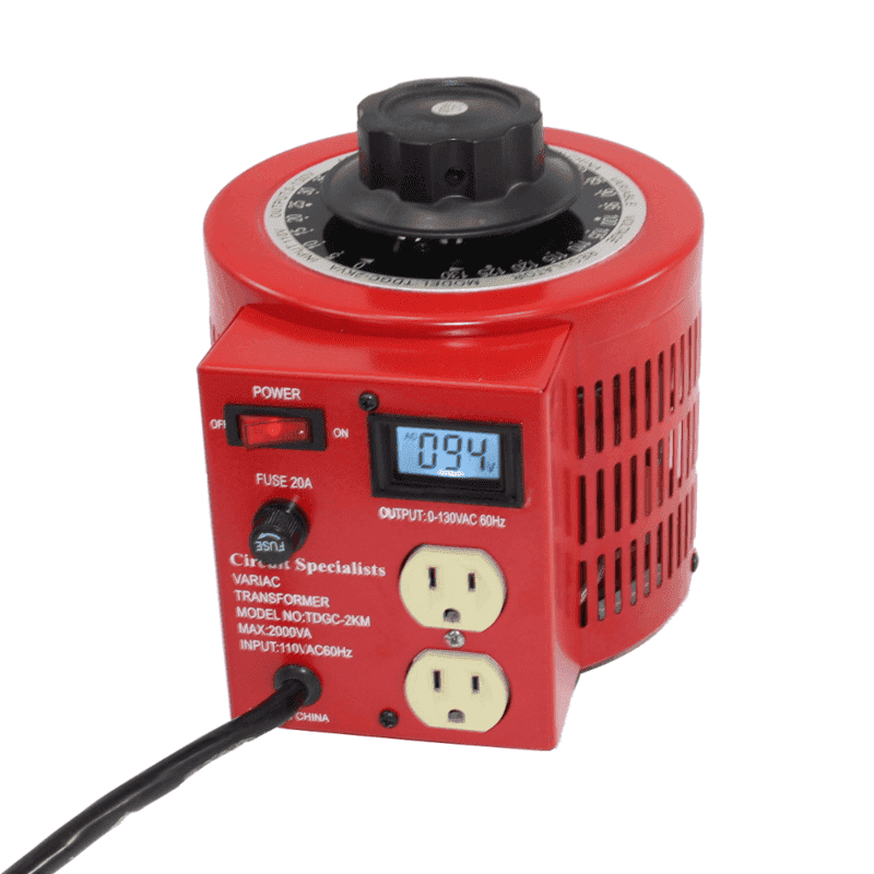

That sounds promising, and experimenting with an autotransformer can be interesting. I have an infinitely variable version of that, commonly called a Variac.
Please note that the neutral is connected at A and is common to both ‘primary’ and ‘secondary’. So you have a mains reference at the output, and a shock from there will be every bit as dangerous as a mains shock.
The lower voltages you propose are still potentially unsafe for amateur experimentation with such a set-up. I suggest you look up ‘isolation transformer’ and tell us what you find.
I would have bought that; it would have saved me from the trouble of running to stores to buy things. But the ones on the net are asking for incredibly high prices.
