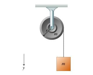

Find magnitude of angular accelleration alpha, express in terms of radius r and gravity
2. torque = rF, F=ma
3. T = mg
torque = rF = -Tr = I*alpha
-mgr = I*alpha
alpha = -mgr/I
with I = 0.5 mr^2 I get:
alpha = -2g/r, which is incorrect.
Why t=ma.It is not stationary.it is moving.so mg-T=ma
The body is moving with an acceleration of a which is alpha*r
I'm still not getting the solution.
Using ma = mg - T
I*alpha = -Tr
a = r*alpha

I don't really get what you did.You don't have to put - at the equation Tr=I*alpha.Also alpha=a/r.try this
I*alpha = -Tr because T exerts torque in the negative (clockwise) direction.
Nevertheless if you put numbers you would found the same.The idea though is the one i wrore you.i hope i helped.if you have more questions just ask

Which is the correct answer?Try to solve as to T.T=-I*alpha/r
and also write alpha as a/r.then put T at the equation mg-T=ma
is the correct answer 2g/3r?
Yes, how did you calculate this?
How you obtain all this?-Tr=0.5mr^2*a/r so T=-0.5ma
Then mg -T=ma so mg-0.5ma=ma so 3/2*a=g so a=2g/3
