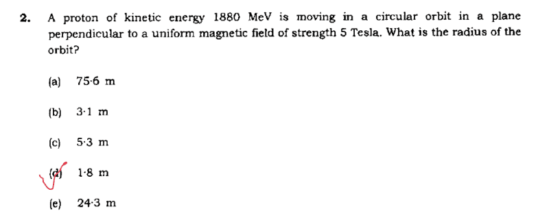

Snell's law is written ## n_1 \sin(\theta_1)=n_2 \sin(\theta_2) ##. For this case ## n_1=\sqrt{\epsilon_{r1}} ##, and ## n_2 =1 ##. ## \\ ## ## \theta_1 ## is the angle of incidence inside the material, measured from the normal. There is a ## \theta_1 ## for which the left side of the equation is equal to 1. What happens if ## \theta_1 ## is such that the left side of the equation is greater than 1 ? Can you get a solution for the right side in that case, to determine the emerging angle of the refracted ray? ## \\ ## Editing: This problem is slightly tricky: If ## \theta_i=90^o ##,(the steepest angle of incidence at the entry point), ## \theta_r=\sin^{-1}(1/n_1) ##. The resulting ## \theta_1=90^o-\theta_r ##. I'll let you try to finish it up. Meanwhile, the file you uploaded is apparently the wrong one.
