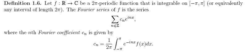

I am so stuck on my revision and i really need someones help!
I am using the definition of Fourier series as
My lecturer has told us that
if f is odd.
Could someone please tell me how he has derived this because i can't understand how he's got to it, iv tried using trig identities and i just can't get it!
and could someone also tell me what the equivalent is when f is even?
Thanks!

I am using the definition of Fourier series as View attachment 34807
My lecturer has told us that View attachment 34808 if f is odd.
Thanks!
