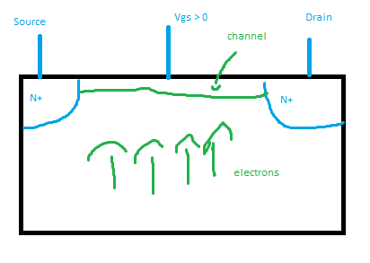

Hi,
I'm studying MOSFET in detail and I'm struggling to understand how the channel is formed in case of SOI Mosfet.
For normal mosfet
A positive Gate to source voltage attracts electrons from P substrate towards Gate and thus a channel is formed.
But in case of SOI
There is a buried Oxide film so how will electrons go towards Gate and form the channel? How is the channel formed in SOI Case? I tried google but only came across Fabrication Process of SOI and its advantages and drawbacks.
Any insight would be helpful?
The electrons which form the channel flow out of the N+ source and drain.
Then what is the purpose of dopimdthe substrate with light P doping. I can just use a Normal semiconductor with no doping.
You can't really build a semiconductor with no doping. In silicon, for example, to get truly intrinsic silicon (no doping), the impurity level needs to be below the intrinsic free carrier level of about 1E10 atoms/cm^3. Since silicon has about 10^23 atoms/cm^3, this means the material has to be pure to better than the part per trillion level, which is very difficult or impossible. So the substrate will be either lightly N-type or lightly P-type. If it is N-type, then you have an ohmic leakage path between the source and drain. If it is P-type, there are back-to-back diodes between the source and drain, so the leakage is very small.
Thanks. This makes sense that due to fabrication constraints we dope the substrate with light P type. This helps a lot.
