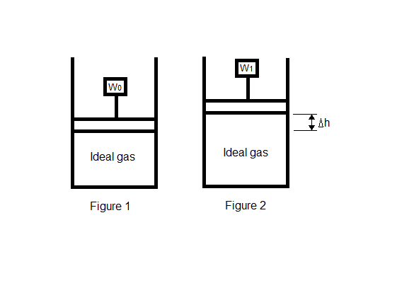

1. Given the set-up in Figure 1, how much work will be done after part of the weight is removed, as shown in Figure 2, knowing only the height the piston rises?
2. W=mC[P](T[2]-T[1])+mg(h[2]-h[1])
3. W=mC[P](T[2]-T[1])+(m[2]-m[1])g(h[2]-h[1])
Two cylinder diagrams with a piston holding a weight, containing ideal gas. Figure 1 shows weight W0 on the piston. Figure 2 shows weight W1 with the piston raised by a height marked Δh.
I think you need to go through your posts and explain how you have approached each problem so that we can give you answers that will make sense to you.
Indeed - the equations won't make much sense without some discussion.
The use of ##C_p## kinda suggests constant pressure is assumed doesn't it?
