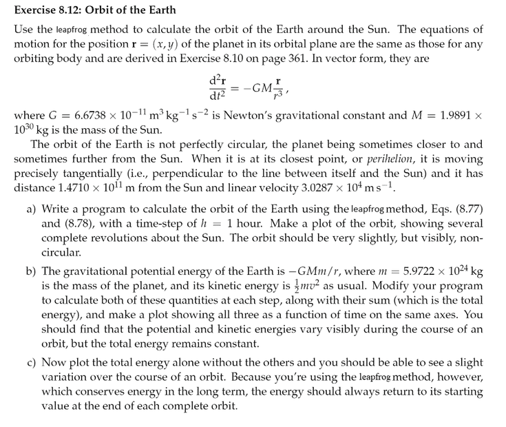

I am attempting this homework exercise part b).
Screenshot of a homework exercise titled Exercise 8.12: Orbit of the Earth, with parts a) to c) on using the leapfrog method, including the equation d2r/dt2 = -GM r/r3.
I've modified my code but I get error overflow message. My goal is to modify my code so it returns kinetic and potential energy of Earth's orbit.
I made a new f(z,t) and modified the rows 99 and 100 with dz[2]=-G*M*m/r, and dz[3]=0.5*m*y**2 but obviously it didn't work.

The equation of motion is exactly the same as in part (a) so you don't need to change the integration. What information do you think you need to calculate kinetic and potential energy?

Aha! So I use the result from part a) to compute the energies:

I get these plots now. Did I plot it correctly? Shouldn't total energy oscillate between 0?

Looks about right: the key point is that total energy is more or less constant, (with a relatively small oscillation which is an artefact of the leapfrog method: you'll probably cover this in the next lecture).
