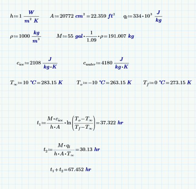

I am trying to calculate the rate of thaw for a 55 gallon drum of frozen juice. I know the surface area of the drum is 20,772 sq cm. I know the starting temperature of the frozen juice (-10C) and I know the ambient temperature the drum is currently in (10C). What is the equation that will allow me to calculate the time required for the entire contents of the drum to rise to 1C. Thank you!

A good start is to calculate how much heat you need to thaw it and compare that to how much you are putting into the room.
If you assume a relatively thin metal drum and water, you can neglect thermal gradients across the drum.
Assuming convection is the dominant form of heat transfer:
There will be two stages of heat transfer The firs being taking the ice from -10 C , to 0 C. The time ##t_1## would be given by:
$$ M c_p \frac{dT}{dt_1} = - h A ( T - T_{\infty}) \tag{1}$$
Where
##A## is the surface area of the drum
##h## is the average convection coefficient
##M## is the mass of juice (ice)
##c_p## is the specific heat
## T_{\infty} ## is the temp of the environment (assumed large and constant temperature)
The solution to (1):
$$ t_1 = \frac{M c_p}{hA} \ln \left| \frac{ T_o - T_{\infty} }{ T_f-T_{\infty}} \right| $$
The next phase ( 0 C ice to 0 C water) would be heat transfer at a constant rate as the ice completed the phase change to water.
$$ \frac{dE}{dt_2} = hAT_{\infty} \tag{2} $$
Solving (2):
$$ \Delta E = h A T_{ \infty} t_2 $$
The change in energy would be from the mass ##M## and the latent heat of freezing ##q_L##, such that:
$$ t_2 = \frac{M q_L }{ h A T_{ \infty} } $$
The total time ##t##:
$$ t = t_1 + t_2 $$
Thats a ballpark figure I would start with.
Addendum: Convert all temperature to absolute temps ( kelvin scale )

I get about 68 hrs, using a convection coefficient ##h = 1 \rm{ \frac{W}{m^2 K} }## ( that's bottom end of free convection coefficient according to my heat transfer text , which states they are usually between 2 and 25).
I'd say that is as fast as it could be done.

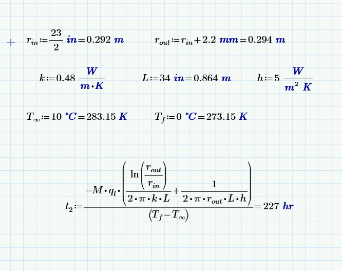

If it is a relatively thick plastic drum, I could believe a significant increase in the elapsed time.
I am noticing an issue though. With that low of a convection coefficient, if it is in this plastic drum [1] HDPE with thermal conductivity ##k = 0.48 \rm{ \frac{W}{m K}}## [2] the time until it would thaw ( just considering the steady state portion 0C ice to 0 C water) is an order of magnitude or two larger!
So depending on drum material realistically, the range of possible times is quite large!

jrmichler said:
The source of the error is thermal conductivity as a material property is in ##W/m-K##, not ##m^2##.
I just used the wrong units in the explanation, the program wouldn't allow that error. Notice the ##k## and units of it in the picture of the computation.
The "problem" is there is a very strong dependency ##h##. By making ##h = 5 \rm{ \frac{W}{m^2 K}}##. Which is still absolutely reasonable I get:
If I allow for the convection from the top of the drum as well (air to material to air boundary conditions) That trims it down a smidge.
I also added the convection from fluid to wall in the radial term for completeness. It's negligible, but I might as well show it.
This is just the time for 0C ice to 0C water.
