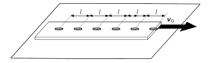

On a long horizontal board lying on the floor of a spacious room, there are ##N## small discs, each with a mass of ##m##. The first disc is at the edge of the board, and the distance between the discs is ##l##. Initially, we give the board with the discs an initial velocity ##v_0##, so that the discs remain stationary, and then we release it. There's a layer of oil between the board and the discs. The magnitude of the force that slows down a disc is directly proportional to its velocity, ##F(v) = b · v##. The coefficient of friction between the board and the floor is ##\mu##. The masses of the discs are negligible compared to the mass of the board. We can consider the discs as point masses.
How many discs will slide off the board until all objects come to a complete stop?"

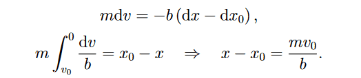

In the solution, they continue with these equations:
where ##x, x_0## are coordinates of a single disc and the board with respect to the ground. So if I understand it correctly, the force acting on a single disc is only one, no matter that the force is dependent on velocity that can be relative. Distance ##x-x_0## is the distance the disc arrives with the moving board until it stops. It is with respect to the ground. But why do they claim that it is a distance with respect to the board?
##x## and ##x_0## are wrt ground, so ##x-x_0## is the displacement of a disc relative to the board.
The question is poorly posed. I interpret this as the old yanking the table cloth trick. I believe the idea is that everything is stationary. At time zero the board is more or less instantly imparted with a velocity ##v_0##. With that description the relevant velocity for friction is the relative velocity of the disks to the board v - ##v_0## and the equation the OP quotes from the solution is correct.

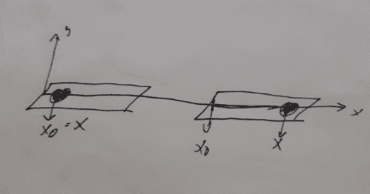

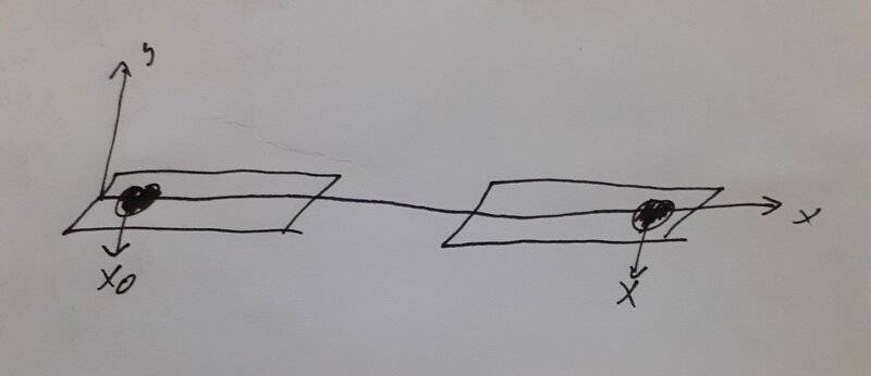

So now I am totally confused. I draw a picture showing how I understand it:
Vybraná fotka
The coordinate system is connected with the ground. This is how I understand that ##x-x_0##, which can't be the distance that the disc travelled with respect to the board, but with respect to the ground.
Is this my visualisation wrong?
## \dot x_o ## is the velocity of the plank w.r.t. ground. ##\dot x ## is the velocity of a disk w.r.t. ground.
## \dot x - \dot x_o ## is the relative velocity of a disk w.r.t. the plank.
So is this correct now?
This is the case when initially, ##x_0=x##, but ##x_0## can also be initially zero. So then it makes all sense.

Cutter Ketch said:
At time zero the board is more or less instantly imparted with a velocity v0.
No, it can't be that.
"Initially, we give the board with the discs an initial velocity "
I.e. board+discs.
"so that the discs remain stationary"
Ambiguous, but probably means relative to the board.
"The first disc is at the edge of the board"
If it were the yanked cloth problem we would need to know far the last disc is from the back edge. See diagram.
I.e. board+discs.
Well, I said the problem is poorly posed! I see what you mean, though. You would really need to know the length of the board or the distance on the left edge. Nevertheless, I think that is what the problem is trying to describe. No matter how you interpret it, v0 is the initial velocity of the board and it is clearly shown as moving to the right. There is no way any coins are falling off the right side of that board. I think they’ve just really screwed up. (certainly one way or another) My best guess of how it’s screwed up: I still say it’s the table cloth yank problem.
The disks are carrying momentum ##mv_o## at time ##t=0##. The plank (not the disks) immediately begins to feel the force ##\mu M g ##, retarding its motion. The disk however feel no retarding force at ##t = 0 ##, they are going to continue on their merry way as the force they experience only grows in proportion to the relative velocity between themselves and the plank (which is initially zero). I don't think its implausible that some coins will fall off the board on the right. If you're talking about "in reality" who knows, but the physics problem seems ok.
