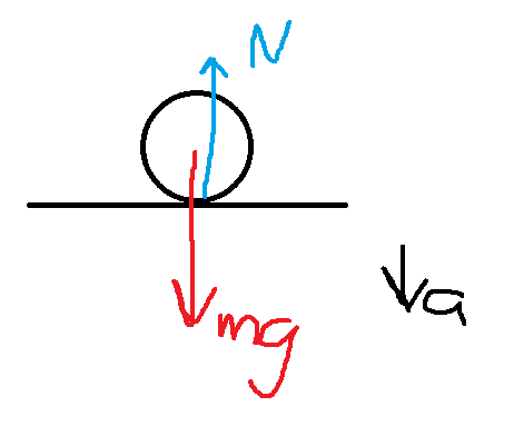

This picture might help

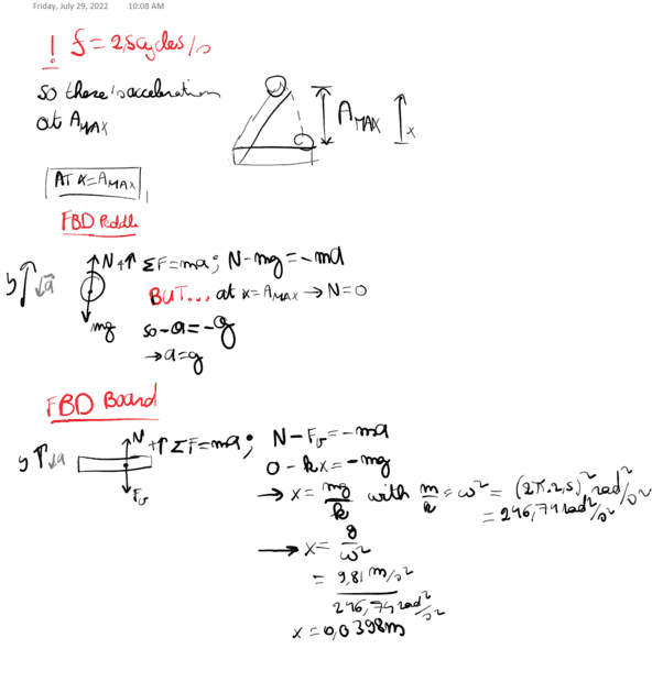

here is my solution with fbd and stuff as well to see where I get the signs etc
only question I am having... isn't there the force of gravity included for the board as well?

The force of gravity on the board is not acting on the pebble, that is the point of FBD. You draw the forces acting on the object of interest.

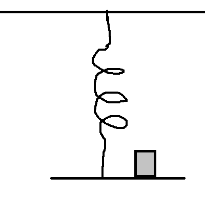

But to see where I am coming with this I refer to the mass-spring system.
If it is put vertically it's EQ. position will be changed due to the force of gravity
Oh wow.. wait, isn't the plank acting as the 'spring' in that case? right.. and if so than the force of grav of the object on the plank aka the pebble matters.

The plank is just like a spring.
