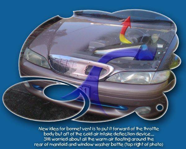

I was thinking for making a custom intake box and cutting a hole in the bonnet for a scoop so. air will get scooped in while driving along at normal temp then straight into the engine.
Depending on the rest of the design (carburetor or fuel injection, etc), you may end up doing more harm than good with respect to fuel mileage or power. If a simple hood scoop was "worth it" don't you think that the manufacturer would have also figured that out. On the other hand, I really like the idea that there are still guys out there who like this kind of tinkering and questioning and trying things out. So, go for it - and let us know what you find.

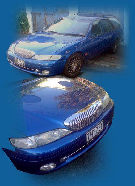

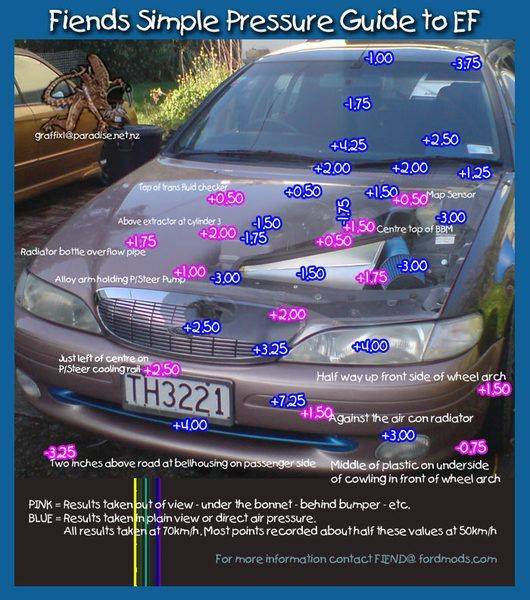

Hi there. I am researching exactly the same thing at the present time. I've gone past thinking about putting holes in the lid and have done it... I searched using google for ten minutes with the search ""how much does air expand due to temperature?"" as I've done all sorts over the last few months on a very limited budget and the most important thing for air intake is really air pressure at intake mouth (in my opinion - not being a scientist or mechanic of any note.)

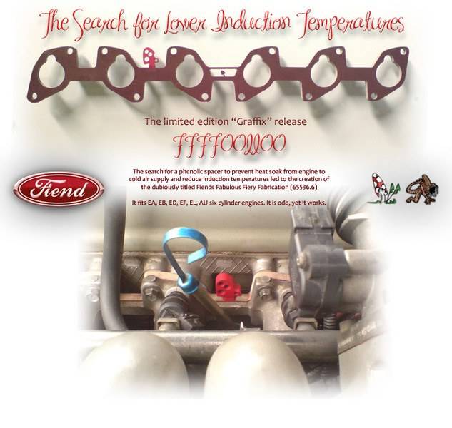

Have also made this...
As you can see it is a Phenolic spacer of 8mm thickness that I designed to stop heat transfer from the alloy head to the alloy Broad Band Manifold (BBM) system. A BBM provides a long air path at low engine revs and uses a vacuum line to move butterflies and provide a short air path from throttle to combustion chamber at mid - high revs. It is all computer controlled from 3D tables, but you can see an example of it kicking in by looking closely at a dyno reading...
This example is probably not the clearest, but you can see a fluctuation around the 4000rpm mark. It may drop or rise in revs depending on throttle position, load, etc.
Where was I?
Oh yes - I have been testing this spacer installation of mine for a while now and am happy to report that the highest temp reading from the middle of the throttle butterfly has dropped from the high 60's (degrees in Celsius) to the mid 30's. This astounded me, and it is simply too good to believe so I am now lurking around with pocket protector wearing Physics Dudes on the net rather than telling the skinned knuckle and tattoo brigade over at http://www.fordmods.com !
Obviously temperature drops of this nature are going to be good for an internal combustion engine. I am actually on this site as a result of searching for air expansion due to temperature so I can be armed and ready for the disbelieving masses...

Am not a big fan of scoops as such, but the holes in my bonnet work very well indeed at letting heated air out of the engine bay. Has anyone else ever wondered why all the waste air from the radiators and oil cooling systems is expelled straight into an engine bay (and more often than not - directly onto an area affecting the air intake temperature? Now, that is something that manufacturers should do something about.
