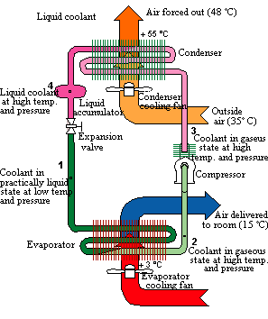

mech-eng said:
Heat pumps can transfer heat from a lower temperature system to a higher temperature system. So I can't see how the definition applies in this case. Would you please explain how definition covers this situation?
If you take the heat pump as a black box, then your statement in correct. However, if you look at the inner workings, the temperature of the working substance is below the temperature of the low-T reservoir when heat is taken from it and it is higher than the high-T reservoir when dumping heat into it. So it is compatible with the definition of heat.
(Note that I am skipping over the phase transitions that happen in most real-world heat pumps, which involves latent heat also.)

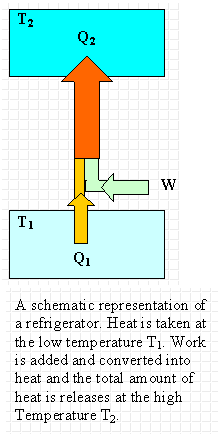

Do not heat pumps prove wrong, or falsify, the "temperature difference" part of the definition?
The indoor air, or your skin, does not know the difference between a cold coil and a block of ice, it will yield some of its thermal energy to that cold source.
The outdoor air does not know the difference between a hot coil and a rock heated by the Sun, it will gain some of their thermal energy from that hot source.
In order to keep the cold coil cold and the hot coil hot (avoiding indoors and outdoors thermal equilibriums being naturally reached), additional external energy must be constantly used.
Please, see:
https://en.m.wikipedia.org/wiki/Second_law_of_thermodynamics
http://labman.phys.utk.edu/phys136core/modules/m3/refrigerators.html
https://en.m.wikipedia.org/wiki/Thermodynamic_equilibrium
:cool:
