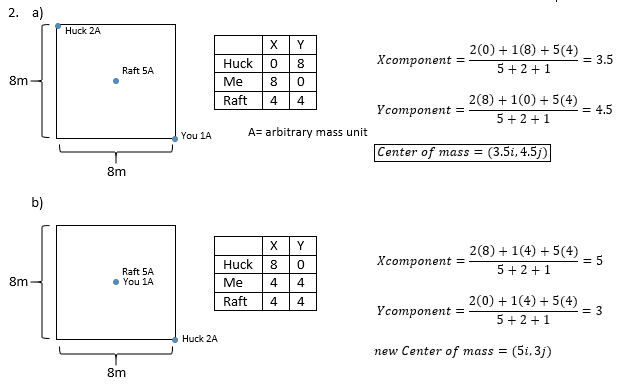

How much does the raft move with change of position?

heres the problem...
and i figured out part a but don't understand how to get the second part, here is what i have done...
my question is should the angle be from the point of origin? what I am getting is -2.12 meters in a direction of -45 degrees. is this correct? I'm using x2-x1/y2-y1 to get 1.5/-1.5 then using Pythagorean to get the distance of shift and using arctan(-1.5/1.5) to get the -45 ?
The vector does not need a reference point, just a reference direction. Relative to the x-axis should be fine. Or relative to some other direction which you clearly describe. Like "from the center towards the new position of [...]".
The magnitude should be positive.
So could I say the raft moves 2.12 meters in a direction of 135 degrees when viewing form above?
If you clarify 135 degrees relative to what, sure.
relative to the point of origin (bottom left corner)... looking at it from above it would move into the the third quadrant , of course the raft would stay square to the x and y axis
