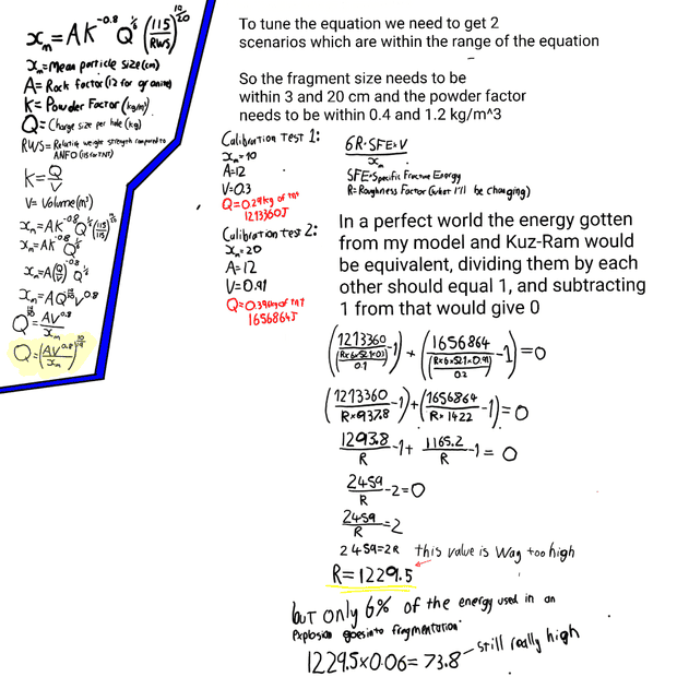

I am interested in trying to find how much energy needed to blow up stone and is looking for a bit of help
So I am trying to find the amount of energy needed to break apart stone into different sized chunks (when either punching it or blowing it up) and I'm using this method to estimate it:
  1. Assume the object got broken up into cubes of the desired diameter
  2. Find the surface area of all the cubes
  3. Multiply this area by a "roughness factor" to account for smaller pieces, the fact that fragments won't be perfectly smooth etc
  4. Multiply the new area by the specific fracture energy to get the energy needed
So my first question is if this is a valid method of estimating the energy needed? If not what would be a better method
Assuming that this model is correct I made a spreadsheet with all the specific fracture energies of materials I could find and got the "Destruction values" from them. Some of these values seem a bit low (this spreadsheet says that 100 kilotons of TNT would be enough to completely fragment mt fuji into chunks of 40cm or less) so I decided to use the Kuznetsov equation to change the roughness factor, basically "tuning" the model
So what I did is I got 2 situations from the Kuznetsov equation and attempted to change the roughness factor value as much as possible to make it align. From this I got a value of 1230, which is really high as that means it takes half a kiloton of tnt to turn 1 cubic meter of silver to dust. Even using the fact that only 6% of the energy of blasting goes into breaking rock and using a reduced value of 75 we still get a value that is higher than the value needed to vapourise the cubic meter of silver As calculated here
Edit: to elaborate on the tuning thing I did, what I did was that I calculated the tons of tnt used in 2 situations which should be usual in blasting operations (Powder factor of 0.7kg/m^3 for granite, and 2 charge values which result in average particle sizes of 10 and 20 cm) Then I put the 2 scenarios back into my method and tuned the roughness factor to get it as close as possible and landed on a value of 1230 which is way too high
So am I doing something wrong? I'm happy to answer any questions about my method

So that would involve looking at stuff like the Kuz-Ram model? if so how would I generalise stuff like that to pulverising objects (because the Kuz-Ram model is a series of empirical equations that were built for fragmenting stone into cm sized pieces not dust) and generalising to blowing up materials that aren't stone (like steel, concrete and even more esoteric materials like gold and silver)
Also I kinda tried doing that before and got a value for turning silver to dust which was higher than vapourising it entirely and many more probably had energies higher than what was needed to melt them

If anyone is wondering this is how I did the "calibration" of my model
I used sketchbook because I don't know how to use Latex

I may have figured out why the calibration using Kuz Ram might have been so high. One of the main critisms of the Kuz-Ram model is the fact that it doesn't take into account fine particles, which would be very relevant with my model because those would reduce the mean particle size by quite a bit and add a lot of crack surface area
Edit: Also what would reasonable values be for turning 1 cubic meter of stone into fragments/dust? I might try the calibration thing again
anuttarasammyak said:
I enjoyed reading https://en.m.wikipedia.org/wiki/Mill_(grinding) to know what they do in making powders.
Ok, so I'll look into crushing and see how much energy is used to do that and I'll then use it to calibrate the model again (hopefully this doesn't come out to something stupid again)
This should be more accurate as the energy transfers should be less complicated and more of the energy should go into fragmentation
So I did the calibration thing again with the Bond Work index of different materials and I got a roughness factor of 256.2, which is way too high as it says that the energy needed to pulverise many materials (Steel, Stainless Steel, Silver, Aluminium, Tin, Copper, Bronze, Brass, Zinc, Tungsten, Gold, Calcium, Titanium and Chromium) is higher than the energy needed to melt many materials and for Silver the energy predicted by this model is higher than the energy needed to vapourise it.
So is there a fundamental problem with the way I'm calculating this? And if there isn't why every time I attempt to do some sort of calculation with this the values are way off?

So what I did here is to estimate the crack surface area as the total area of the cubes, which would include faces that are already exposed. But as the fragment size gets smaller compared to the object size it gets more and more accurate (and given I'm going to use this to calculate stuff like mountains exploding I think it's fair.
So my method is given a Cube with side length L, the volume of the side lengths would be L3, and given a Fragment size of R the volume of each fragment would be R3, so the number of fragments would be L3/R3.
The surface area of the fragments is 6R3, so the total fragment area would be
L3/R3 * 6R2 or more simply
6L3/R
Then I multiply the area by the SFE to get the energy
E = 6*SFE*L3/R
And since we want energy per volume we can divide the expression by L3 to get
D = 6*SFE/R
But I realised that the crack area may be quite a lot larger than what the cubes may suggest, that's why I added the roughness factor
Edit, this model does break down when the fragment size is close to the original size of the object but at that point you could estimate the crack area directly

To get the value of 7.5 I did a similar tuning method to what I did here with the Kuz-Ram model, and that gave me a value of 256.2. I then realised that only 3% of the energy of crushing goes into the fragmentation of stone, so I multiplied 256.2 with 0.03 to get 7.69. I rounded down to 7.5 for conveniece's sake
