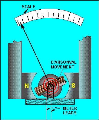

How does a PMMC instrument read average value of a dc waveform? Is it true for pure dc or pulsating dc as well? I mean what will the meter show if I fed a full wave rectifier's output to it? Will it show its average vaue 2Vm/π? If yes, I don't understand how. Say the meter is an ammeter. So, the current will be pulsating and hence the torque will also be pulsating. How will the pointer come to rest at the average value on the dial? Is there any specific arrangement inside the meter or am I missing some key physics principle here? Same goes for a moving iron instrument. I know that the torque is proportional to the square of current but the current is alternating;hence the torque should also be pulsating. How does the pointer come to rest at the rms value on the dial?

Where it comes to rest is determined by Force balance, sum of torques = zero
current causes clockwise torque
that's opposed by a coiled hairspring giving counterclockwise torque proportional to angular displacement
when the two are equal the needle stops
try a search on d'arsonval movement
http://www.tpub.com/neets/book3/7b.htm

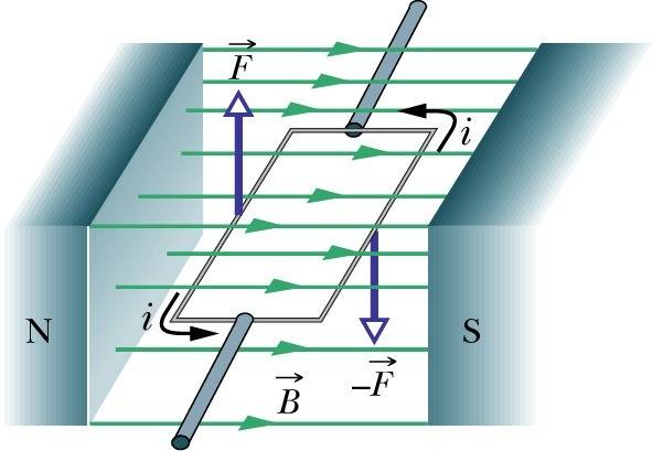

and on T(orque)=NIABsinθ
http://helios.augustana.edu/~dr/203/203-s02/img/F29_20.jpg
^there's your electromagnetic torque proportional to current, NIABsinθ
and red spiral in other picture is the opposing hairspring that makes mechanical torque kX , where k is spring constant and x is angular displscement
NIABsinθ = kX ,
If you add inertia it looks like an invitation to oscillation, doesn't it ? Displacing force plus restoring force with no mention of damping? Harmonic motion?
Needle increases both its moment of inertia and damping from air friction.
The metal band on which coil is wound is a shorted turn for magnetic damping. To visualize magnetic damping look at videos of dropping a magnet down a copper tube.get yourself a cheap analog meter and play with it, they're $9.95 at Walmart or ~$2 in junkshops.above all have fun
old jim
