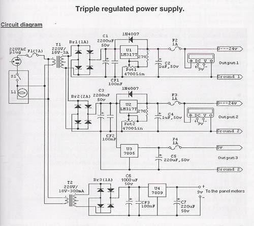

Hey Folks,
Can someone please draw me this circuit to a scheme for drawing it on a pcb maker ? I need it urgently, so please help
Regards & Respect

What exactly are you asking for? You want help with floorplanning this circuit?
Bro,
I need the circuit drawn in a way to replace the devices to a designed circuit ready to be done on a pcb maker ... i mean, to make a real circuit , i want to make the scheme... Please Help ... I need it urgently
Respect
So it sounds like you want to do the PCB layout for this circuit, so that you can make a working version? In that case, you need to get some PCB layout software package like OrCAD or Allegro or P-CAD, and do the layout. I doubt that anyone on PF will do it for you. There are some free layout software packages, but I'm not familiar them. I have some friends who have used free layout packages provided by some PCB fab houses (that's how those houses get your business), and it has worked fairly well for simple PCBs like your voltage regulator board. Check out this list at Circuit Cellar Magazine's website:

I already have the layout in my head, if I only could transfer it to the pcb maker.
Either way, the schematic itself doesn't have enough information to do a layout anyway. You'd also need to provide a bill of materials indicating the packages of each component.
And no, no one on PF is going to spend several complete days laying out a PCB for someone they've never met... for free.

it doesn't need that time bro, it just needs someone to know how to draw it and put the wholes where the component should be putted . Can someone please just draw it on a paper and i'll work on it on a simulator ? Please
Respect
Designing a decent PCB for a board with two dozen components will take at least two days. In industry, an entire week would probably be allocated to it. And I have no idea what you're talking about with the "simulator." You don't simulate PCBs, generally...
I have no idea why you're trying to make a PCB layout for this board, but you are unfortunately in well over your head. Your best bet would be to call a contractor and have him/her lay it out for you, for a cost.

i guess that i didnt explain well ... all that am asking is someone to draw the same circuit but istead of putting the symbols of resistance, capacitors, ... keep a blank space and put the wholes where the real components should be soldered

We all understood you perfectly. You're asking for someone to layout a printed circuit board for you. Keep in mind that the devices do not necessarily have the same size and shape as the symbols on the schematic; in fact, the schematic doesn't even indicate which packages the devices are in. Also, keep in mind that physical features like power and ground planes are not represented on the schematic. Laying out a PCB is a much more challenging task than simply leaving a blank space and putting down holes.
- Warren
Lol man, designing a PCB is not as easy as you think. Routing wires is tricky. There are several other issues like seperating the power, analog and digital signal paths, making optimum sue of filter caps, picking the right pcb material, providing ground planes, component placement geometry etc.

Something you might consider.. If you're just wanting to test and get a working circuit, you may consider prototyping it on a http://eeshop.unl.edu/proto.html#BREAD , it allows you to experiment with placement of your components.
I would recommend trying out just a section of your power supply (such as one 24v supply) initially, once you get that working, the other ones are quite similar.
