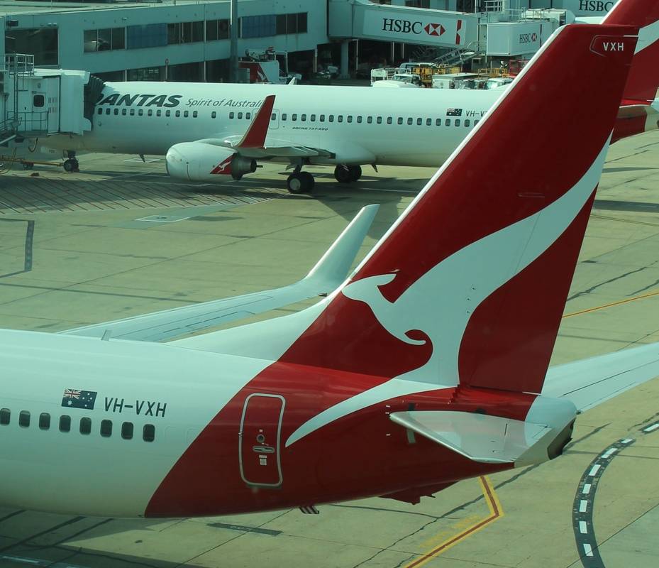

On a typical light aircraft, glider or model aircraft you have a fixed horizontal tail plane with hinged movable elevators behind.
On a supersonic jet fighter you don't have separate tail and elevators, instead its all one surface called an All Moving Tail.
On many passenger jets you have a combination of both. There is a tail plane and separate elevators but both can move. I might be wrong but as I understand it typically the pilot controls the elevators and the electronic flight systems control the angle of the tail plane. The pilot can also control the tail plane via the manual trim wheel.

  • #50
You can see the AMT feature and separate elevators in this photo from Google Images...
https://upload.wikimedia.org/wikipedia/commons/3/3a/Qantas_Boeing_737-800_Registration_on_tail.jpg

Is the AMT what looks like flaps on the elevators?
No. The AMT is the whole horizontal tail airfoil. There is an axle that runs down the middle of the airfoil from the plane fuselage to the tip of the tail airfoil, and if you look at the leading edge of the tail airfoil there is a slot in the fuselage for the moving front support. You can see marks painted on the fuselage at the leading edge showing three AMT angles (probably nominal, max up and max down).
