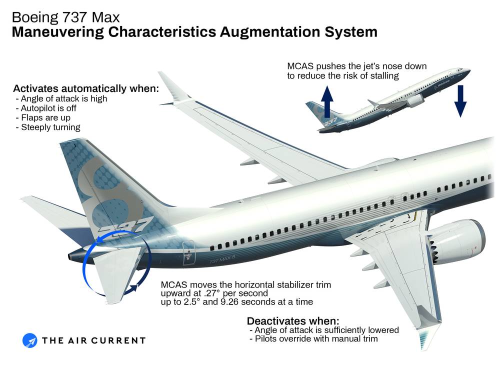

They aren't two separate things. Giving the feedback means adding more nose down trim, which, if the pilot does not compensate by increasing the force he uses on the yoke, will pitch the nose down. Any adjustment of trim does the same thing: it changes the force the pilot needs to exert on the yoke to maintain a particular pitch attitude.

MCAS adding more nose down trim provides the feedback regardless of whether the pilot changes the force he's exerting on the yoke or not and also literally is pitching the nose down if the pilot does not change the force he's exerting on the yoke.
See the bolded statements I added. (And note that they apply for any method of adjusting the trim, not just MCAS. The same things would be true if the pilot manually added nose down trim using the trim wheel, or whatever manual trim adjustment system the aircraft has.)

This says "Using electric pitch trim will only pause MCAS, to deactivate it you need to switch off the STAB TRIM SUTOUT switches." This seems to indicate that the cutout switch the pilot comment we were discussing referred to does disable MCAS.

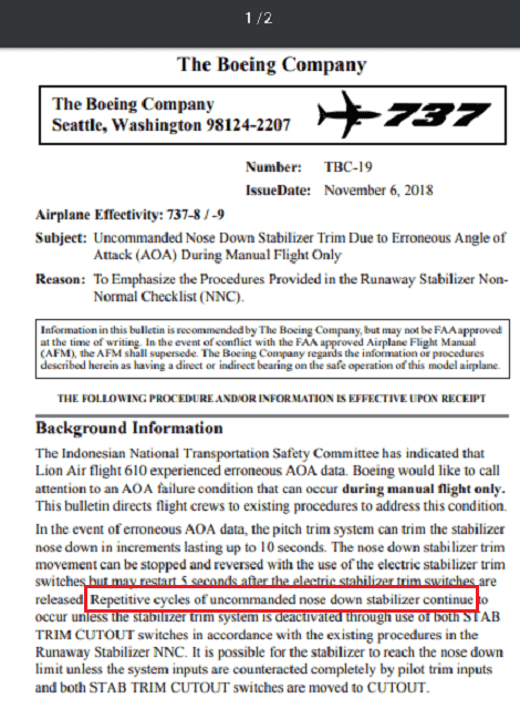

Right, it also has a note underneath that that says, "High control forces may be needed to correct any stabilizer nose down trim already applied." Then it says to use electronic trim control to correct it first, then cutout, then manual can be used after.
This sounds ridiculously cumbersome in the event of the MCAS operating in error, where the plane can literally be in a dive at fast airspeed. Really I think what we're going to see is a complete revamp of the MCAS system if it can even be redesigned effectively.
In fact this is alluded to in the March 11, Continued Airworthiness Notification to the International Community (CANIC):
Reviewed Boeing’s production processes related to the AOA vane and Maneuvering Characteristics Augmentation System (MCAS)
