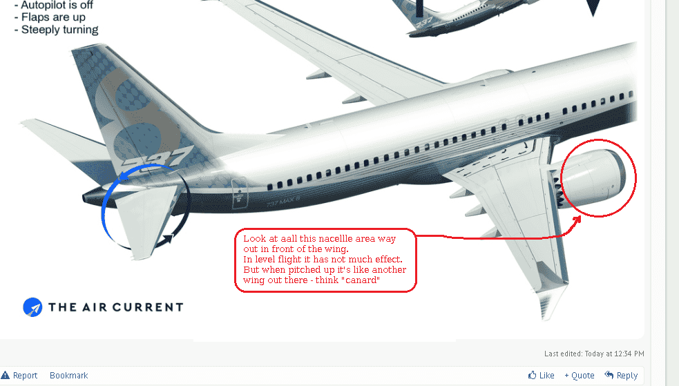

Caveat to some of the previous info:
https://theaircurrent.com/aviation-...aracteristics-augmentation-system-mcas-jt610/
There are a couple of ambiguous things in descriptions of MCAS:
1. I believe, but am not certain, that the anti-stall system is separate from the MCAS. But it could be that they are two different functions of the same system. That wouldn't change the logic, only the grouping of the terminology.
2. Some sources, such as the above, say the MCAS moves the entire stabilizer, not just adjusts the trim tab (the graphic doesn't match the text of the article). That seems incongruous with other sources. I don't think it is correct, but I am not certain.
