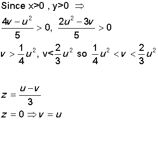

Handwritten-style derivation: since x>0, y>0, inequalities 4v-u^2 over 5 > 0 and (2u^2-3v) over 5 > 0 give v > u^2/4 and v < 2u^2/3, so u^2/4 < v < 2u^2/3; below, z = (u-v)/3, and z = 0 implies v = u.
Something like this?

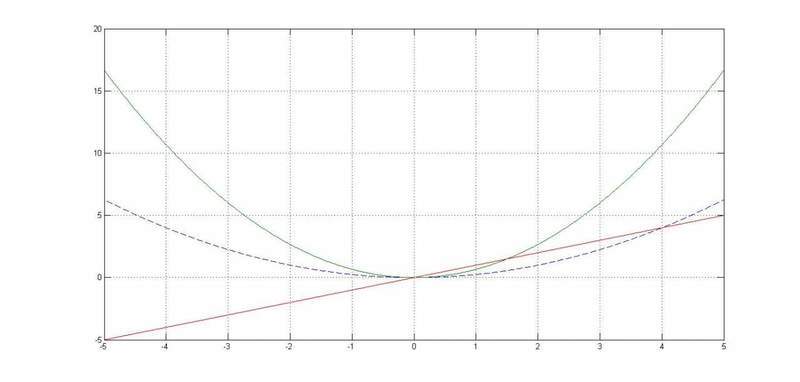

Here is graph:
  • Graph on a grid with x from -5 to 5 and y from -5 to 20, showing a green parabola opening upward with its vertex near the origin, a blue dashed parabola opening upward more narrowly, and a red straight line through the origin with slope 1.

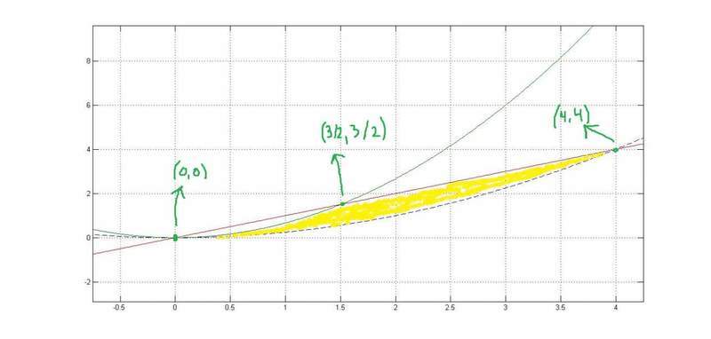

That's the sort of thing - shade in the u-v plane regeon that corresponds to the region you are integrating over and the next step should be apparent.
you have $$v_1 > \frac{u^2}{4}, v_2<\frac{2u^2}{3}, v_3<u$$ ... blue, dashed, and red lines respectively.
your graph is v vs u - good choice - you want to shade the area between the two parabolas that is also under the line.
It looks like what I'd do... you've certainly got the right idea.
Well done.
