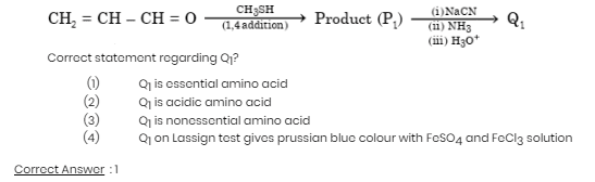

I put the question in the form of a picture/attachment below.
--no equations i think--
The question:
Multi-step reaction scheme: CH2=CH-CH=O with CH3SH (1,4 addition) gives Product (P1), then (i) NaCN, (ii) NH3, (iii) H3O+ gives Q1. Below are four multiple-choice statements about Q1 and the marked answer, option 1.
How will the first reaction take place for instance? Is CH3S- the nucleophile? Will it be added to the oxygen and the other hydrogen(H+) get attached to the other oxygen, with the double bond shifting to the center(C2-C3)? If this is right then where will CN- will attack?
The problem statement tells you that it's a 1, 4 addition. Can you describe what that means?
Yes. Start with those pieces of information and see what you can come up with.
