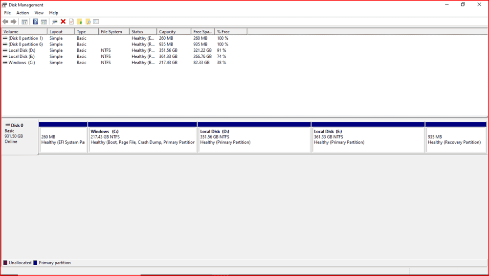

I have had enough with my Windows PC. I have decided to create a dual boot PC with Ubuntu 20.04 LTS.
I am doing a dual-boot system because I need Windows for:
  • Amazon prime video app
  • MS office
Here is a view of the partitions of the HDD:
I have a lot of programs to install:
  • MATLAB
  • Android Studio
  • MySQL
  • Java (JDK)
  • Python
  • Git
  • Intellij IDEA
  • MikTex
  • TeXmaker
  • Arduino
  • Fritzing
  • Softmaker Free Office 2018
  • OBS Studio
  • Zoom
I was thinking of doing the following:
  • Shrink C: drive by 100 GB (or maybe more).
  • Shrink D: and E: drives by 54 GB each.
On Ubuntu, I will mount D: and E:. These are the places where I will save all my files — media, documents, etc. I will reserve 8 GB for the swap area. My question is, how should I distribute the other 200 GB space in Ubuntu? Should I allocate all the space to / (root), or should I create a separate /home partition?
A few other questions:
  • In Windows, it is possible to shrink and extend partitions. At a later stage, can I shrink and extend partitions in Ubuntu?
  • I was seeing this video on how to set up Linux to automatically mount NTFS drives at boot using the GNOME disks utility rather than modifying fstab manually. Some people are saying that this mounts the drive read-only. How do I provide read and write permissions to the mount?
This will be my first time on Ubuntu, so any other advice (in general) is also appreciated.

I haven't seen a setup like that for a long time: why do you have 3 partitions?

I've got a better idea: spend a few quid on an SSD - it doesn't need to be huge (256MB is enough) but get the best you can afford - and if you can't afford Samsung then only go as far as 2nd tier (Kingston, SanDisk etc), stay away from no-name brands.
Install a clean copy of Windows on the SSD, then your chosen Linux distro. I would aim for the following structure:
Windows: 160GB
Linux: 80GB
Any excess you have, split evenly between the 2.
Consolidate your HD into 1 partition, formatted as NTFS. Use this just for media files which you can load from either OS (although if you want to edit them I would recommend copying over and back to the SSD).
I wouldn't recommend sharing data files between OSs, keep them separate (in the main partitions).
The main advantage with having a separate /home partition is that it makes it easier to dual boot between different Debian-based distributions. If you think you might want to switch around, you could do this (but see my recommendation on trying out VMs first below), otherwise there is no point.

I find it easier not to store too many files on C: drive.

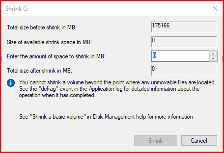

New problem: Even though I have 150 GB free in C: drive, I cannot shrink the partition:
Following online tutorials, I cleaned up the disk, de-fragmented it (using Windows and third-party contig.exe software), and got only 46 GB. I believe it's time to completely replace Windows.
Update: This is me writing from Chrome on Ubuntu. 🙋‍♂️ The installation was successful; completely wiped the hard disk. Now I have to install all the software.
