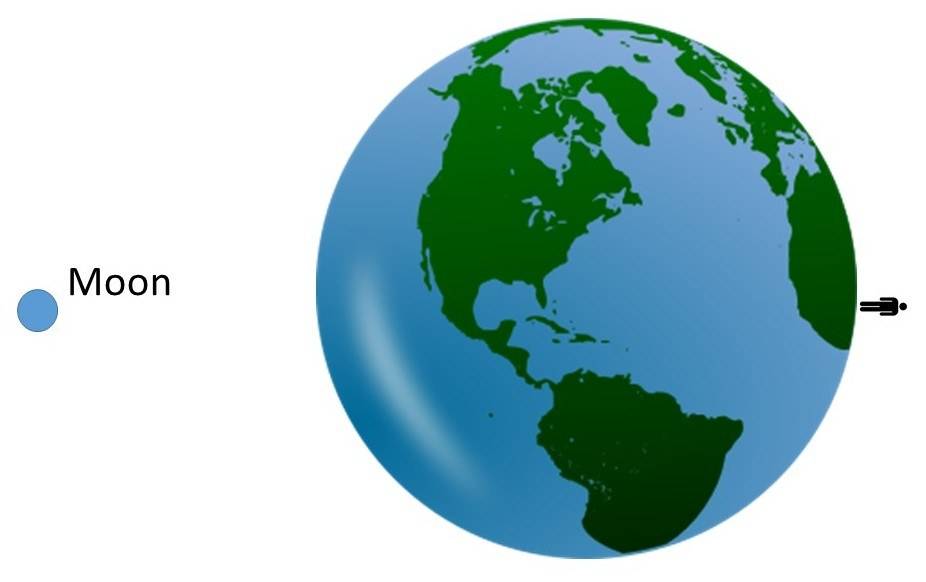

Refer attachment. The distance between Io moon to Jupiter and our Moon to Earth is nearly the same. also, diameter, density & gravity are nearly the same. The ratio of gravity for Earth/Moon is 80.4 times vs ratio of gravity for Jupiter/Io is 20276.7. Also, Jupiter has reduced Io’s gravity by 0.68m/s2 vs Earth has reduced Moon’s gravity by 0.0027m/s2. If Io escapes its absolute gravity will be 1.8+0.68=2.48m/s2 vs Moon’s absolute gravity is 1.62+0.0027=1.6227m/s2.
How the role of Mass justified for the above cases in Newton's gravitation laws & in Einstein's GR?
This seems to refer to the moon's centripetal acceleration due to Earth's gravity. It is a mistake to word this as a reduction in the moon's gravity. If I were to place a weight scale anywhere on the moon, it would read my weight as say 150N anywhere on the moon, and this would not change at all if the moon happened not to be in orbit about anything. Ditto with IO. There's no reduction of gravity going on.
There are tidal effects which may be significant, but 0.0027m/s2 is not a measure of tidal acceleration or force.

Note that, On Earth's surface, Moon's attraction effect reduces our weight by 3.31E-5 N/kg. We can directly say Moon reduces Earth gravity in a similar way. I hope you understand what I want to say.
It does not. Please show your work.
I get less than 1.2E-6 due to tidal forces on nearside:
GMm/(R-re)2 - GMm/R2
To compute the same on the moon, switch all the m and e subscripts.
I get less than 1.2E-6 due to tidal forces:
...and that's positive or negative (or zero) depending on where you/the moon is.

Dang, I fell into the OP's trap; yeah, tidal force is always negative (up) - it's the OP's idea I suspect (stationary bodies) that would have positive or negative forces.

we know Moon gravity reduces the effect of Earth's surface gravity
No. We don’t know that. It is wrong.
No. This is wrong. Or at least it is not right everywhere on the surface. This will change in magnitude and direction on the surface
Not sure if we mean the same by "tidal force", but it is "up" at the near and far side, while being "down" at 90° to that.

rajen0201 said:
how?
At one point on the surface the moon is “up”, on the opposite side it is “down”, and in between it is “horizontal”.
I think the OP is adding (vectorially) the effects of Earth and Moon gravity vectors for a position with the Moon overhead. So, in the Antipodes, the attractive forces would add so weight would appear to be greater. But, as has been mentioned, this ignores the small matter of the mutual Orbit.

How is the gravitational force on the person "reduced" here by the moon?

Moon reduces whole Earth's gravity it is not like near side & far side.
Please show me the physics you are using the arrive at this error. In particular, draw a free-body diagram for that person.
