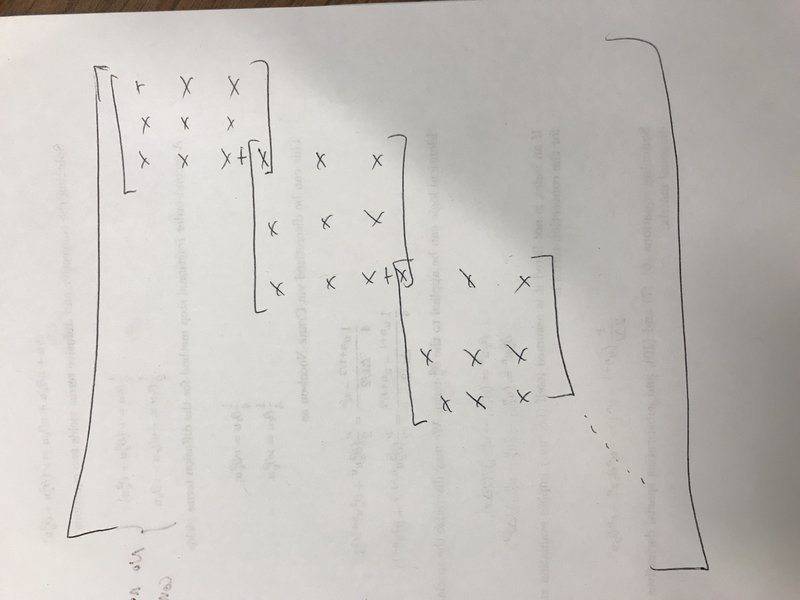

Hi PF!
Let's say I have a 3X3 matrix ##K## and a much larger square matrix, call it ##M##. I am trying to add ##K## into ##M## along the diagonals. It's difficult for me to explain (and hence code) so I've attached a picture. Does anyone know a good way of doing this? Notice overlap is only in the corners.

jedishrfu said:
Are you trying to do a convolution?
I am not. I'm ultimately solving a BVP via finite elements. So when constructing a global matrix ##M## I have to superimpose ##K##s onto it as described.
I guess I’d do this with a couple of for loops. There may be a clever vector scheme but I don’t know Mathematica at all.

joshmccraney said:
Hi PF!
Since you're trying to insert a 3x3 matrix into blocks on a larger matrix, the size of the larger matrix should be 3m x 3m.
Along the lines of what @jedishrfu suggested, you'll need an outer loop that inserts a 3x3 matrix each iteration, and an inner loop that inserts the values for each 3x3 matrix.
The first 3x3 matrix will go in positions (1, 1), (1, 2), (1, 3), (2, 1), (2, 2), (2, 3), (3, 1), (3, 2), (3, 3).
The next 3x3 matrix will go in positions similar to the above, with the upper left index being (4, 4) and the lower right index being (6, 6),
And so on.
The "inner loop" that I mentioned above might actually need another loop nested inside it.

From post #1:
This wasn't clear in your first post. So instead of having separate blocks that go down the diagonal, the lower right entry of a block is also the upper left entry of the next block, and this entry is the sum of the corresponding elements from the two blocks. Is that what you're trying to convey?From post #6:

joshmccraney said:
I tried showing this in my picture, but I'm not much of an artist. Do either of you know the syntax to compute this triple loop in Mathematica? I've looked it up but the nested loops are confusing for a Mathematic novice like myself.
joshmccraney said:
Perhaps this will clarify my question from above:
this is what I have so far in Mathematica
Code:
For[L = 1, L <= 1/h - 1, L += 2,
What is the value of h?
Mark44 said:
From post #1: This wasn't clear in your first post. So instead of having separate blocks that go down the diagonal, the lower right entry of a block is also the upper left entry of the next block, and this entry is the sum of the corresponding elements from the two blocks. Is that what you're trying to convey?
Yes! Thanks for phrasing it so concisely.It should work. Try this:

The issue I face now is solely Mathematica syntax. Specifically, how to allow the size of M to be a function of h in the loop?
Here's a first cut with some working C++ code that produces the matrix I showed in post #3. I'm sure there's a lot of room for improving my code, to make it more general. I'm not familiar with Mathematica, but possibly you can translate this into Mathematica code.
