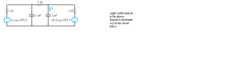

Apply nodal analysis in the phasor domain to determine ix(t) in the circuit below.
This is super confusing to calculate in the phasor domain, I was just wondering if anyone could check my calculations and see if they get the same answer that I do.

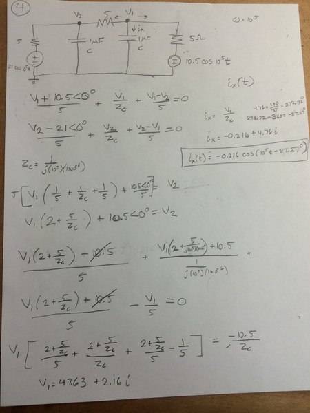

Here is my attempt
