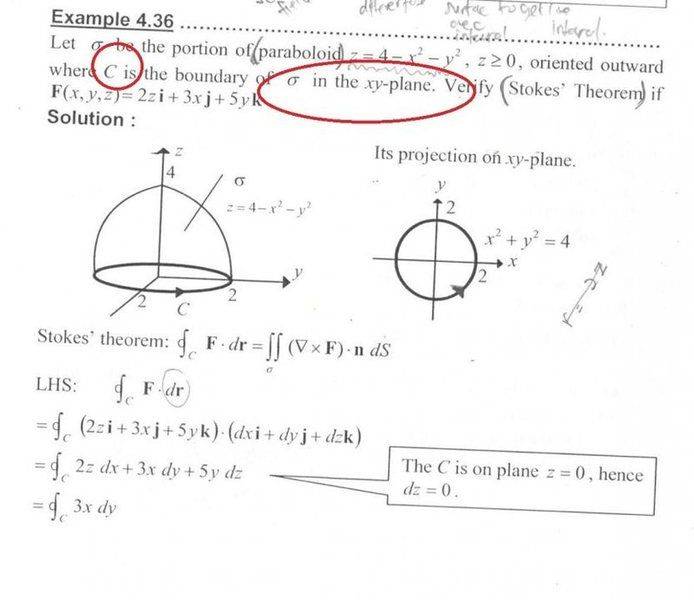

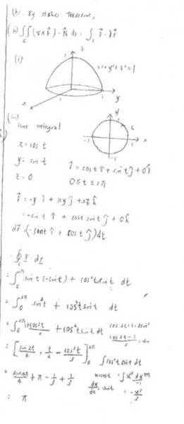

In the first and second photo , it's stated earlier that the C is the boundary of surface on xy plane , but in the question in the 3rd picture , it's not stated that the C is on which surface , so , how to do this question ?
For ∫F.dr , i am not sure how to get r , coz i am not sure i should to use which surface as 2d projection .
In the first photo , it's stated earlier that C is on xy-plane , so xy - plane projection is used.

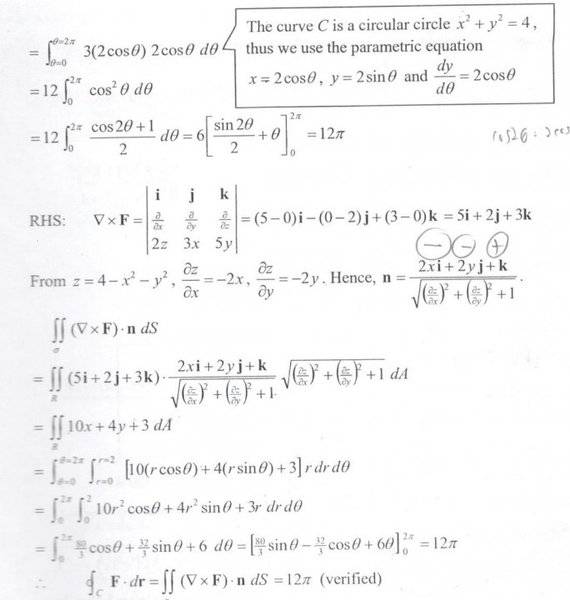

In the solution provided in the 4th photo , the author use xy plane projection , is the concept correct ?
  • Worked solution to Example 4.36 showing a hemisphere sigma with boundary circle C in the xy-plane, its projection circle x^2 + y^2 = 4 with radius 2, and the line integral of F.dr reduced to 3x dy.

  • Handwritten worked solution of a Stokes' theorem problem: parametrising the circle x^2 + y^2 = 4, computing the curl of F and the surface integral over z = 4 - x^2 - y^2, with a boxed note and the result 12π.

  • Handwritten calculus working: a hemisphere sketch labelled x^2+y^2+z^2=1 with axes x, y, z, a unit circle in the xy-plane, and a parametrisation x=cos t, y=sin t, z=0 for 0≤t≤π with r = cos t i + sin t j + 0k, followed by line-integral steps.
Not an area I know, but it looks to me that you can define C as the boundary in xy plane and that allows you to apply Stokes' theorem.
