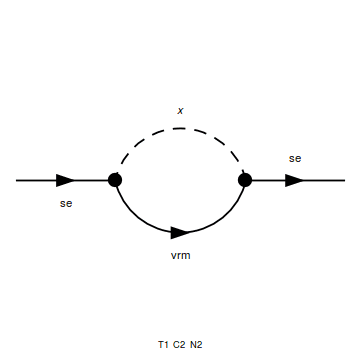

I try to calculate the squared amplitude of the following self energy digram :
where se is massless Dirac fermion , and vrm is massless right handed neutrino. x is a scalar with mass m ..
I wrote the nominator of this process as:
N = ## \bar{u}(p) (1-\gamma_5) (p\!\!\!/ +k\!\!\!/ ) (1+\gamma_5) u(p) \to p\!\!\!/ (1-\gamma_5) (p\!\!\!/ +k\!\!\!/ ) (1+\gamma_5) \to p\!\!\!/ (1-\gamma_5) (p\!\!\!/ +k\!\!\!/ ) \to p_\alpha \gamma^\alpha (1-\gamma_5) (p_\alpha \gamma^\alpha + k_\beta \gamma^\beta ) \to p_\alpha p_\alpha \gamma^\alpha \gamma^\alpha +p_\alpha k_\beta\gamma^\alpha \gamma^\beta - p_\alpha \gamma^\alpha \gamma_5 p_\alpha \gamma^\alpha - p_\alpha \gamma^\alpha \gamma_5 k_\beta \gamma^\beta ##
I don't know how the first term as ## p_\alpha p_\alpha \gamma^\alpha \gamma^\alpha ## can be calculated or the third term .. also I don't know how ## P.K## which comes from the second term can be calculated from the process kinematics ? while ## P^2 =0 ## and ## K^2 = m_\chi^2##
Note that: the momentums of the particles in the Feynman diagram are se(p), vrm(p+k) and x(k)
Also the "x se vrm " vertices come from these Lagrangian terms:
## y (\bar{\nu_R^c} \chi s + \bar{s} \chi \nu_R^c ) ## (where s-> se, ##\chi ## -> x and \nu -> vrm)
Thanks ..

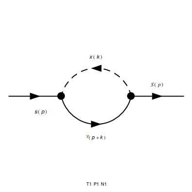

I will say why .. please look the following Feynman digram of the process
I have in N ## p\!\!\!/ ## comes from the spinors and ## p\!\!\!/ ## appear in ## (p\!\!\!/+k\!\!\!/) ## from the fermion propagtor, so it's the same momentum or p .. I wonder if it will be meaningfull if i used different indecis for like ## p_\alpha \gamma^\alpha (1-\gamma_5) (p_\delta \gamma^\delta + k_\beta \gamma^\beta ) ## ?

Safinaz said:
So some thing is not clear now, do I write the spinors?
The self energy ##\Sigma(p)## is usually defined as just the 1PI blob, for which at lowest order your diagram would contribute. There are no spinors involved. You can of course write down the expression for ##\bar{u}(p)\Sigma(p)u(p)##, but I am not aware what this expression would mean. What observable do you want to calculate?
Safinaz said:
I have in N p/p/ p\!\!\!/ comes from the spinors and p/p/ p\!\!\!/ appear in (p/+k/)(p/+k/) (p\!\!\!/+k\!\!\!/) from the fermion propagtor, so it's the same momentum or p .
That is why you call it ##p## both times. But the contracted indices mean summation e.g. ##p_\alpha\gamma^\alpha = \sum_{\alpha=0}^3 p_\alpha\gamma^\alpha##. The sums in the two ##\slash{p}## expressions have their own indices.
Safinaz said:
I wonder if it will be meaningfull if i used different indecis for like pαγα(1−γ5)(pδγδ+kβγβ)pαγα(1−γ5)(pδγδ+kβγβ) p_\alpha \gamma^\alpha (1-\gamma_5) (p_\delta \gamma^\delta + k_\beta \gamma^\beta ) ?
That would be the expression.
So now "P.K" or ##p_\mu k^\mu## what does it equal ? 'd we use CMF kinematics here ? but I wonder how ..
Well , ##k^\mu## is the loop momentum you are integrating over, so you need to calculate something like ##p_\mu \int \frac{d^4k}{(2\pi)^4} \frac{k^\mu}{D}##, where ##D## means the denominator corresponding to your diagram.
