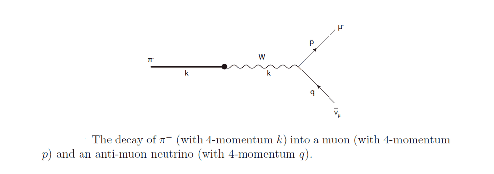

I am computing the decay rate for the pion into a muon and anti-muon neutrino but I do not get the desired expression *, so I would like to discuss the calculation
I am studying the following process: pion decays (mediated by the charged ##W## boson) into a muon and anti-muon neutrino (i.e. ##\pi^- \to \mu + \bar{\nu}_{\mu}##). The Feynman diagram associated to it is
And its Feynman amplitude is (where we of course neglected ##\mathcal{O}(m_{\mu}^2/m_{W}^2)## and higher orders and assumed that the anti-muon neutrino is massless).

You forgot a ##\gamma_\mu##!
Oops, indeed! 😅

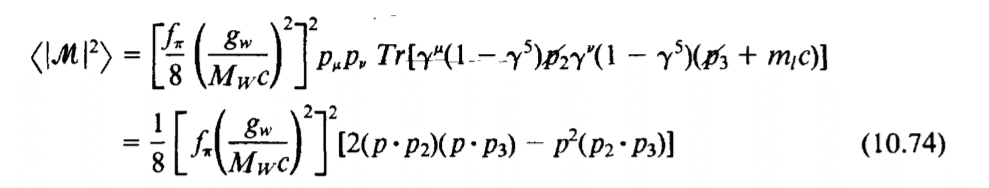

By the way, the trace I wrote down in the OP is not the one we are looking for. I have corrected my original mistake but I would still like to check a detail of my computation
\begin{align*}
&p'_{\mu}p'_{\nu} tr\left[\gamma^{\mu}(1-\gamma_5)p \!\!\!/ \gamma^{\nu}(1-\gamma_5)(q \!\!\!/ + m_{\mu}) \right]\\
&= 8 p'_{\mu}p'_{\nu} \left[ p^{\mu}q^{\nu} + p^{\nu}q^{\mu} - \eta^{\mu \nu} \left( p \cdot q\right) - i \varepsilon^{\mu \nu \rho \sigma}p_{\rho} q_{\sigma} \right] \\
&= 8 \left[ 2(p' \cdot p)(p' \cdot q) - p'^2\left( p \cdot q\right) -ip'_{\mu}p'_{\nu} \varepsilon^{\mu \nu \rho \sigma}p_{\rho} q_{\sigma}\right] \\
&= 8 \left[ 2(p' \cdot p)(p' \cdot q) - p'^2\left( p \cdot q\right) -ip'_{\mu}p'_{\lambda} \varepsilon^{\mu \lambda \lambda \sigma}p_{\lambda} q_{\sigma}\right] \\
&= 8 \left[ 2(p' \cdot p)(p' \cdot q) - p'^2\left( p \cdot q\right) \right] \\
\end{align*}
So is it OK to justify that the ##\varepsilon## vanishes due to relabeling two of the dummy indices as above ( given that repeating two of the indices of ##\varepsilon## makes it vanish by definition)? Or is there another reason?

By the way, my trace computation matches Griffiths'
It vanishes, because ##\epsilon^{\mu \nu \rho \sigma} p_{\mu}' p_{\nu}'=0##, contracting the antisymmetric Levi-Civita symbol with an expression symmetric in the indices ##\mu## and ##\nu##.
