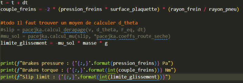

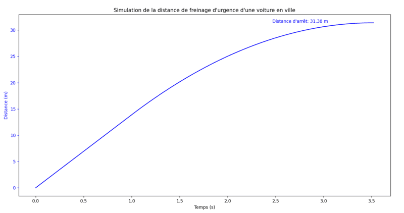

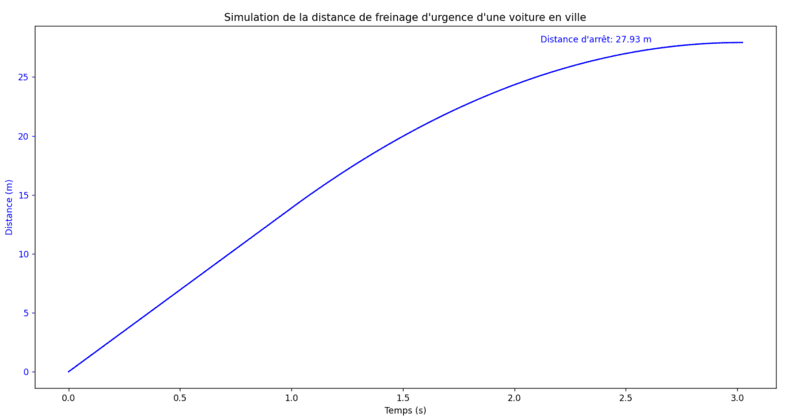

I have remake the code using all of your advice and I get this :
Seems fair with France's official numbers: 28 meters
But this is considering there is slipping all the time : ##F_B > \mu Mg##
In fact after the calculations :
Brakes pressure : 5,000,000 Pa = 50 bar
Brakes torque : 45,744 Nm
Slip limit : 5,699 (##\mu Mg##)Why is the limit so low compared to the brake force ?? There has to be a maximum of 5 bar of pressure for the car not to slip, but according to what I find online, disc brakes tend to work around 30-50 bar, and a lot more if the brake pedal is hit hard, so I would expect emergency braking pressures to deal with 100 bar or so

Let's start at the beginning. How did you get these numbers? Show us your calculations. Show us your sources for your input numbers.
These numbers are found by that (in loop):
Python:
couple_freins = -2 * (pression_freins * surface_plaquette) * (rayon_frein / rayon_pneu)
limite_glissement = -mu_sol * masse * g
if abs(couple_freins) > abs(limite_glissement):
    F_eq = limite_glissement
else:
    F_eq = couple_freins
M_eq = masse + n_roues_actives * moment_inertie_roue / rayon_pneu**2
a = F_eq / M_eq
v = v + a * dt
x = x + v * dt
I was just printing the absolute values of pression_freins, couple_freins, and limite_glissement.
The parameters used are
Python:
masse  = 830 # Masse de la voiture
v0 = kmh_vers_mps(50) # Vitesse initiale
rayon_pneu, rayon_interieur, largeur_bande = ref_roue_vers_dimensions('155-65R14')
rayon_frein = rayon_interieur * 0.8 # Approximation de la distance par rapport à l'axe où la pression est appliquée
n_roues_actives = 2 # Nombre de roues actives

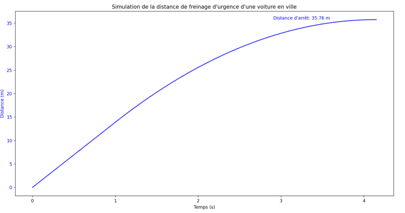

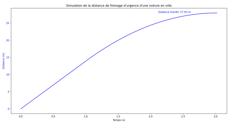

Okay then
If I input a pressure greater than 5 bar I always have the same graph because the tire slip
Here with 50 bar
With 5 bar and less I have :
For 5 bar :
For 4 bar :
For 7 bar :
For any value greater or equal to 7, the graph is exactly the same
yes, it was 6, not 5, but that's not a great deal
So what you are saying is that the graphs show that slip becomes a factor at a pressure of 7 bars.
The relationship between slip and brake pressure is buried somewhere in your code. Rather than post a calculation, you have chosen to treat the program output as a valuable source of truth and presented that instead.
So let me see if you have posted enough code to reverse-engineer a calculation.
What I see is 23 lines of code. The comments are in French and I do not speak the language, so that will be a handicap. That is entirely my problem and not yours. I imply no criticism.

Working from the main loop outward.
I see incrementing time. Perfect. ("t = t + dt")
I see you computing the the torque on the tire as:
"couple_freins = -2 * (pression_freins * surface_plaquette) * (rayon_frein / rayon_pneu)"
Note that the "surface_plaquette" here appears to be the total surface area of all four brake pads on one side of all four rotors. Things do not make sense otherwise. So we have the potential for a factor of four error.
That appears to be mis-named. It is not a torque. It is a force. Worse, it is not the relevant force.
You start with a factor of -2. That much is fine. It is negative because you want it to be a deceleration. It is a factor of two because there is a brake pad on two sides of the rotor. (I hope it is not 2 because there are two drive wheels -- there actually four brake wheels. The brakes are sized differently for front versus rear.
You multiply the brake pressure (pressure of brake pads on brake disc) by the pad surface area. That part is fine as far as it goes. But it is a calculation of the normal force between pads and disk. You need to multiply this by the coefficient of friction of pad on disc to get a figure for the frictional force between pads and disk. That is an error by a factor of 2.5 to 3.
You multiply by the brake radius. That much is fine. If you had correctly calculated the frictional force, multiplying that by the radius of the moment arm would correctly give the resulting torque.
But you proceed to divide by the tire radius. Now instead of a torque, you have a force. Which means that the variable is mis-named. It is a force, not a torque. It is the force that the road would need to supply to balance the torque delivered by the brakes.
Next you have three lines that are all commented out. The first is an actual comment. The next two appear to be lines of code where you would have calculated the coefficient of friction of tire on road based on relative slip rate. But you are not doing that. You will be instead taking the coefficient of friction of tire on road as a fixed constant. That is fine. That is an appropriate thing to do.
Next you calculate the slip limit ("limite_glissement") based on the coefficient of friction, the vehicle mass and g. I do not see that you've defined "g" anywhere, but I confidently assume that it is 9.8 (meters per second squared).
So "limite_glissement" is the maximum retarding force that can be produced by the tires on the pavement. That is a good calculation.
Then we get to the meat of things: "if abs(couple_freins) > abs(limite_glissement)":
This is the critical point where the force (not torque) delivered by the brakes is equal to the maximum force that can be delivered by the road.
Note that I disagree with the code in the remainder of the loop. If one is sliding then the moments of inertia of the tires cease to be relevant and the M_eq variable needs to reflect the total mass of the vehicle plus wheels unmodified by their moments of inertia.
But we need not go there. We have the basis for equation we need to compute the pressure that you are reporting:$$-2 \mu_\text{pad}(P_B A_B)\frac{R_B}{R_\text{ext}} = F_\text{tire} = F_\text{slip} = -\mu_\text{road} M g$$
We are solving this for ##P_B##. Everything else is considered as input. We already know that you've implicitly estimated ##\mu_\text{pad}## as 1 when the correct value is somewhere between 0.3 and 0.4.
What is your estimate for ##A_B## ("surface_plaquette")?
Code:
surface_plaquette = 0.0057390
So that is 0.0058 square meters. 58 square centimeters or about 9 square inches. I have no good way of checking this figure for accuracy. How did you arrive at it?
##R_B## we have already belabored at length.
##R_\text{ext}## I think we can trust that you've computed correctly from the tire's labelling.
##\mu_\text{road}## and ##g## I have no objection to. ##M## for the vehicle mass, I trust you. As you've said, your car is small even by French standards.
We are also missing clarity on whether you are comparing the computed 7 bars of pressure against typical pressures for brake pad on rotor or for typical pressure of brake fluid in the lines.
