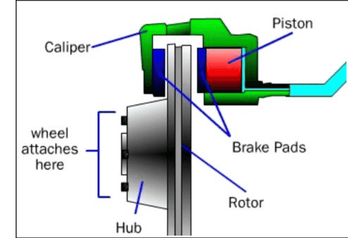

How to Calculate the Braking Momentum on a Wheel?
The discussion revolves around calculating the braking torque on a hollow-cylinder wheel model, specifically focusing on the interaction between brake pads and the wheel. Participants explore concepts related to torque, force, and the moment of inertia, while addressing terminology differences and the implications of various braking systems.
  • One participant defines the force exerted by the brake pads as F = μpS, leading to a proposed momentum M = Fd.
  • Another participant corrects the terminology, emphasizing that the term "momentum" should be replaced with "torque" in this context.
  • A participant expresses confusion about the term "moment arm" and its role in calculating torque, seeking clarification on the variable r.
  • Discussion includes the definition of moment of inertia and its relevance to the braking system, with references to standard shapes and their moments of inertia.
  • Participants debate whether the braking system involves just a wheel or a vehicle, noting that the angular acceleration may depend on the vehicle's kinetic energy.
  • Clarifications are made regarding the distinction between "moment" and "momentum," with acknowledgment of translation issues in terminology.
  • Questions arise about the symmetry of forces acting on the wheel and the nature of the braking system being discussed, with some participants suggesting that the forces may not add up constructively.
Participants generally agree on the definitions of torque and moment of inertia, but there are multiple competing views regarding the specifics of the braking system and the implications of force symmetry. The discussion remains unresolved regarding the exact nature of the braking forces and their effects.
There are limitations in the assumptions made about the braking system, particularly concerning the symmetry of forces and the specific type of brakes being discussed. The terminology differences may also affect the clarity of the discussion.

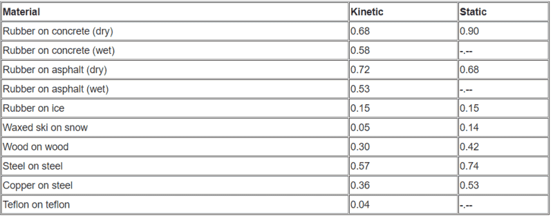

  • #93
I'm sorry I missed that thread earlier.
If you are looking for a distance, you start with an equation that has a distance in it. You want to relate it to a force? We have a simple one that uses both, the definition of work:
$$\Delta E = F\Delta x$$
Where ##F## is an applied force, for a distance ##\Delta x##, that will require (or dissipate) an amount of energy ##\Delta E##. So:
$$ \Delta x = \frac{\Delta E}{F}$$
How can we relate this to a braking vehicle? Obviously, the force ##F## is the braking force. For the energy, we know the car will change speed during braking, thus changing its kinetic energy ##\frac{1}{2}mv^2##.
But what is the braking force? Well if we assume we are braking with the friction force created by all the tires supporting the car and that all tires have equal characteristics, then the braking force is ##\mu mg##. So:
$$\Delta x = \frac{\frac{1}{2}m(v_f^2 - v_0^2)}{\mu mg}$$
Or:
$$\Delta x = \frac{1}{2}\frac{v_f^2 - v_0^2}{\mu g}$$
That is the base in a very simplistic manner. The stopping distance required for the car speed to drop from ##v_f## to ##v_0## only depends on the tire-road coefficient of friction ##\mu##. We don't even know how the torque is applied to wheels, we just know that it creates a friction force; a friction force that has an upper limit set by ##\mu##.
But let's elaborate on the equation a little bit further.
First with the energy of the car. A car has also parts that rotate, like the wheels but also the braking system, driveshaft, transmission gears, etc. These parts will also reduce their RPM as the car slows down, which means more energy to dissipate. The good news is that it will be in proportion with the total mass of the car, thus introducing the concept of equivalent mass ##m_e## as shown in post #92. I also suggest this article for a deeper study on the subject. So, to resume, we get:
$$E = \frac{1}{2}m_ev^2$$
Where ##m_e = \lambda m##, and ##\lambda = 1 + \frac{\sum_x I_x g_{r\ x}}{mr_t}##.
##\lambda## depends on the summation of the product of the rotational inertia ##I_x## and gear ratio ##g_{r\ x}## with respect to the wheel for all rotating component ##x##, and the tire radius ##r_t##. (see the article for the derivation).
Second, let's look at the braking force. Yes, there is the tire-road friction force ##F_t##, but there is also the drag ##F_D## and the rolling resistance ##F_R##. So now ##F = F_t + F_D + F_R##.
Oh shoot! ##F_D## has the car speed in it (##\frac{1}{2}\rho C_D A v^2##). We now need to use the differential version and integrate:
$$F(v)dx = m_e vdv$$
Or:
$$\Delta x = \int_{v=v_0}^{v_f} \frac{m_e v}{F_t + \frac{1}{2}\rho C_D A v^2 + F_R} dv$$
(It's a fun one!)
Now, you can use the maximum tire-road friction force as ##F_t## to get the minimum braking distance required to slow down the car. But what if the braking system is unable to make enough torque to create that maximum friction force? Obviously, the distance will be greater. And now we're getting into the heart of your problem.
I'm going to let you digest this introduction and see where you want to go from here.

I think you considered the force to be tire-road friction instead of brake pads-disk friction
  • #99
Yes, because that's what is actually governing the maximum braking force ##F_t## you can get.
But you can get a smaller braking force ##F_t## by modulating the brake pads-disk friction. So you can still extend the equation further by setting ##F_t = MIN(\frac{T_B}{r_t}, \mu mg)##, where ##T_B## is the braking torque from all wheels and ##r_t## the tire radius.

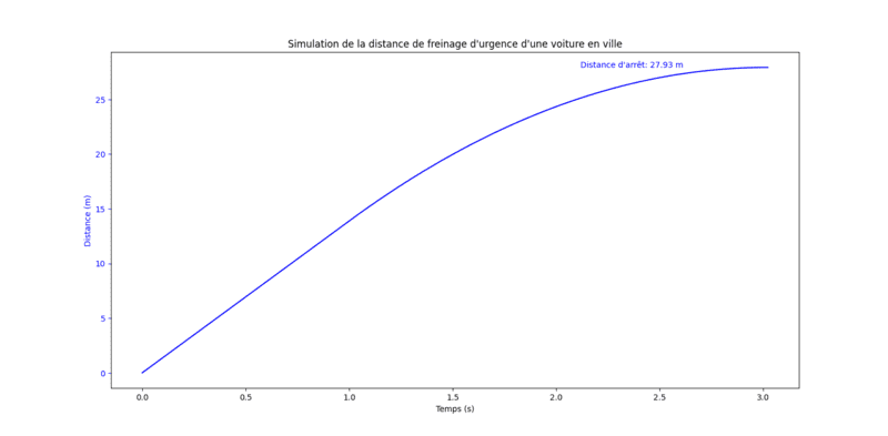

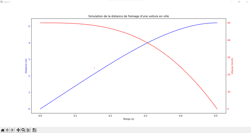

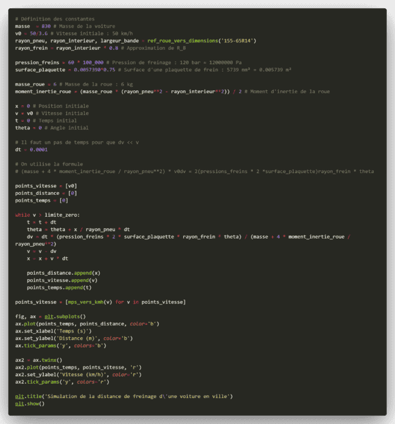

Okay, as I want to be able to simulate the evolution of the distance over time, I will try to figure out ##\text{d}v##
I worked by myself using all your stuff and a bit with my teacher who validated the main part
I use french physics notations, but it may not be a big deal (##J_\Delta = I## for you and I think that's it)
I stopped here last time :
$$\displaystyle \frac{1}{2}M({v_0}^2-v^2) + 4 * \frac{1}{2}J_\Delta({\omega_0}^2-\omega^2) = 2F_BR_B \theta$$
As ##v = v_0 + \text{d}v## (a small step of speed):
$$\displaystyle \frac{1}{2}M((v+v_0)(v-v_0)) + 4 * \frac{1}{2}J_\Delta({\omega_0}^2-\omega^2) = 2F_BR_B \theta$$
$$\displaystyle \frac{1}{2}M((2v_0+\text{d}v)(\text{d}v)) + 4 * \frac{1}{2}J_\Delta({\omega_0}^2-\omega^2) = 2F_BR_B \theta$$
$$\displaystyle Mv_0\text{d}v + \text O(\text{d}v^2) + 4 * \frac{1}{2}J_\Delta({\omega_0}^2-\omega^2) = 2F_BR_B \theta$$
Because ##\displaystyle\omega = \frac{v}{R_\text{ext}}## :
$$\displaystyle Mv_0\text{d}v + 4 * \frac{1}{2}J_\Delta\bigg(\frac{{v_0}^2}{{R_\text{ext}}^2}-\frac{{v}^2}{{R_\text{ext}}^2}\bigg) + \text{O}(\text{d}v^2) = 2F_BR_B \theta$$
$$\displaystyle Mv_0\text{d}v + 4 * \frac{1}{2}J_\Delta\bigg(\frac{1}{{R_\text{ext}}^2}\bigg({v_0}^2-v^2 \bigg)\bigg) + \text{O}(\text{d}v^2) = 2F_BR_B \theta$$
$$\displaystyle Mv_0\text{d}v + 4 J_\Delta\bigg(\frac{v_0 \text{d}v}{{R_\text{ext}}^2}\bigg) + \text{O}(\text{d}v^2) = 2F_BR_B \theta$$
$$\displaystyle\bigg(M + 4\frac{J_\Delta}{{R_\text{ext}}^2}\bigg)v_0 \text{d}v + \text{O}(\text{d}v^2) = 2F_BR_B \theta$$
From here, I have not shown my physics teacher
##\displaystyle v = {R_\text{ext}} \frac{\text{d}\theta}{\text{d}t}## so ##\displaystyle \text{d}v = {R_\text{ext}}\frac{\text{d}\theta}{\text{d}t}## so ##\displaystyle\text{d}\theta = \frac{\text{d}v\text{d}t}{R_\text{ext}}##
As ##\theta = \theta_0 + \text{d}\theta## (a small step of rotation) :
$$\displaystyle\bigg(M + 4\frac{J_\Delta}{{R_\text{ext}}^2}\bigg)v_0 \text{d}v + \text{O}(\text{d}v^2) = 2F_BR_B\bigg(\theta_0 + \frac{\text{d}v \text{d}t}{R}\bigg)$$
$$\displaystyle\bigg(M + 4\frac{J_\Delta}{{R_\text{ext}}^2}\bigg)v_0 \text{d}v + \text{O}(\text{d}v^2) = 2F_BR_B\frac{\text{d}v}{R}\text{d}t + 2F_BR_B \theta_0$$

I want to calculate ##\text{d}v## for each ##\text{d}t## so that I can follow to evolution of ##v## and ##x## over time (I don't care about ##\theta##)
My goal is to use a code such as below
(For your understanding, "frein" = "brake", "plaquette" = "brake pad", "roue" = "wheel", "pneu" = "tire")
Do not take care of the expression in dv = ..., it's messed up
When I run the code, I get this kind of graph (this one is clearly wrong) :
  • #117
I am not going to try to explode that screen image of code to be able to read it. Try pasting it in a [code] block here. For example:
Code:
t = t + dt
  • #118
okay, did not really know how to do it...
  • #119
Sorry, I was just about to edit the instructions into my previous post.
Start by turning off BB code rendering. You can click on the "[ ]" icon above your editing window to do so. That will let you see the "BB codes" in your post. Try it with this post
Code:
t = t + dt
You should see...
[CODE]
t + dt
[/CODE]
You can also go to Info => Help => BB Codes (https://www.physicsforums.com/help/bb-codes/) for more information than you may care for.
  • #120
EDIT: it is maybe not that wrong!
I compared the result (stop from 50km/h in 0.5s in 6 meters) with the official numbers : 14 meters
BUUUT, I did not consider the reaction time (which they do)
If I add to the result about 0.8 seconds of driving at 50 km/h (reaction delay is 1s, I take 0.8 to get the time there is little braking), I get 15 meters.
Not that far...
Anyway, here is the code in the image :
