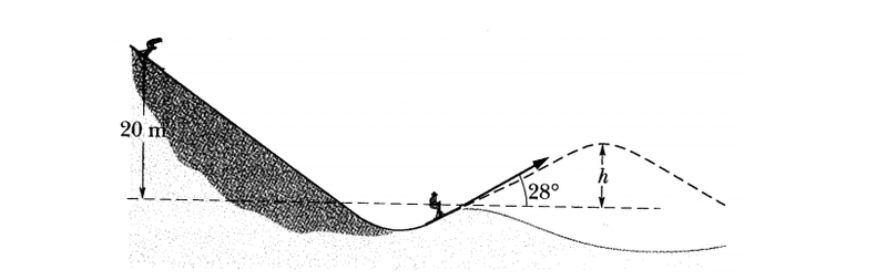

I want to calculate the height h of the skier in this figure
potential energy and kinetic energy and there is no friction
mgh = 0,5 *m*v^2
v=√ (2*g*h)
Now calculate the h when he goes up
mgh= 0,5 *m*√ (2*g*h)^2Am I doing right ?
Thanks
[/B]
What you got is an identity. You need more information of the person on the top of the hill to get his condition, such as velocity~
mgh = 0,5 *m*v^2
v=√ (2*g*h)
This is right but after this, only calculate with its vertical component (v*sin(28 deg)), when calculating h.
These informations are enough, you don't need more!
You only got an identity, because you didnt calculate with the right component of speed.
thank you all
You need to be careful with 'h'. There is a specific height in the problem which is labelled h, and there is the generic h in the equation gh=v2/2. Don't get them mixed up.
First, find the velocity at the launch point.
