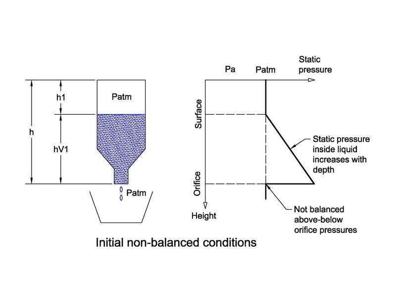

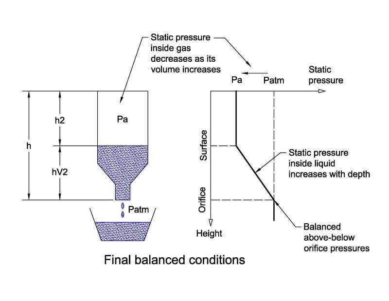

Lnewqban said:
Pretty close; you are almost ready to redo the calculations of that pesky Pa.
Please, see how the initial atmospheric pressure above the liquid becomes Pa:
Very nice illustrations, thank you!
Now I'm a little confused. Patm=Pa+ρhv,1g?

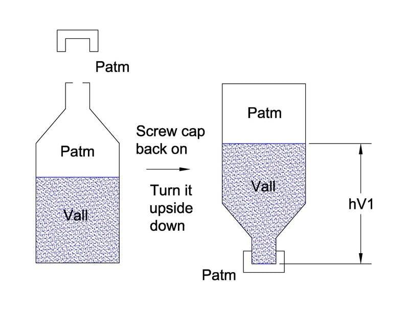

No, when we have the original volume of liquid still inside the glass bottle, which corresponds to hv,1, only atmospheric pressure can be above the liquid.
At that initial point, we have done nothing to increase or reduce that pressure (no one drop has leaked out yet).
So does the Patm push the surface of the water in the same way as the water pushes the cap?
Once the bottle is inverted (but still capped, as shown in the last diagram), the interior face of the cap holds a greater pressure than the atmospheric pressure acting on the exterior face of the cap.
The magnitude of that greater pressure equals the summation of both internal pressures: pressure of gas above water and pressure of column of water between surface and cap.
Please, see:
https://courses.lumenlearning.com/s...-variation-of-pressure-with-depth-in-a-fluid/
