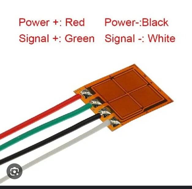

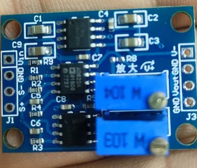

How to connect this strain gauge?
77 replies · 8K views
Micheal_Leo said:
i am very much confused
That may be because you have not read more about potential dividers (and possibly not much about electrical circuits at all?). The idea of a potential divider is to arrange two resistors so that the voltage at their mid point is what you want. You have a formula, in the link I gave you and everywhere else that discusses potential dividers. Where did the idea of a 10k pot come from? What. voltage would you expect with that as R1? If you want to use a variable resistor for adjustment then you need to have a series fixed resistor to limit the maximum current to something safe.
Use the formula to make an equation with just one unknown (the required R1) and three knowns: Vsupply, Vbridge (=1V) and R2.
With 1V applied to the 120Ω bridge, you will have a sensible current. (Work it out)
Micheal_Leo said:
Edit: today the vender told me that
The vendor can't be relied on to know any electronics at all; he may just be retailing meaningless (to him) components. The Power dissipated by a resistor value R, with I current flowing is P = I2R. What does that work out as for 250mA?
Micheal_Leo said:
yes i believe 250mA is still high , i will go for 5-20mA first
How were you planning to do that?
Is your interest here in the results of a mechanical measurement exercise, rather than an electronics project? What is your level of expertise here? It may be better to go for another measurement method or even to buy a unit that works 'on its own' and will interface with your Arduino.

The following calculation is to find Current through strain gauge and R1 needed ,
To get 1V , i need R1 = 480 ohm ,
i have interest in both areas( mechanical and electronics)
i have confusion about wiring
The bridge, 120R drops 1 volt;
1V / 120R = 8.333 mA;
If you have a 5 volt supply, you must drop four more volts.
Use a 120 ohm series resistor to drop each volt.
Four 120 ohm resistors in series with the bridge.
That may be two below and two above the bridge.

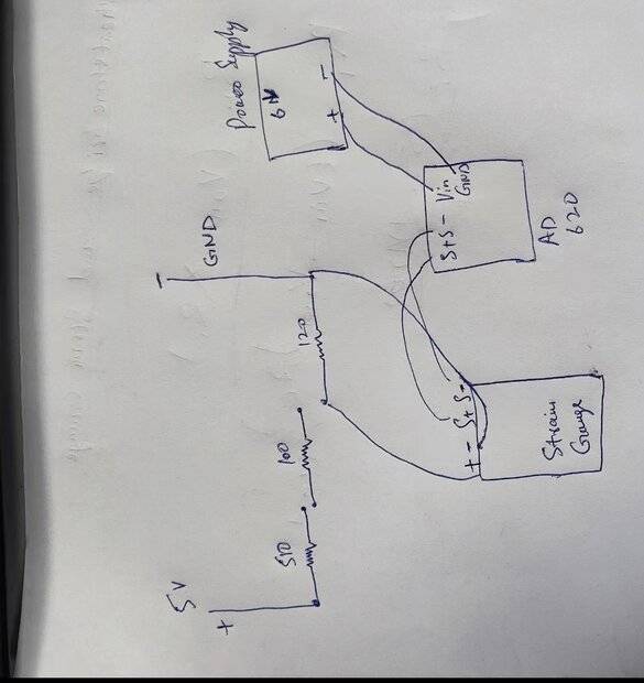

Baluncore said:
4 * 120 ohm is the 480 ohm series resistor.
You must study the common mode input voltage range of the amplifier, to work out if the 120 ohm resistors should be placed above or below the bridge.
I was thinking that's the next stage in implementing. If the amp has + and - supplies then obvs the bridge should be hung between them so the common voltage would be around zero. But if single sided amp then the same thing applies but with half of the 480Ω above and half below. I was wondering if the OP will get this all in one go.

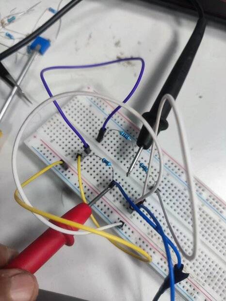

sophiecentaur said:
They are not 'in series' on the bridge. They are in series / parallel - hence the 120 total.

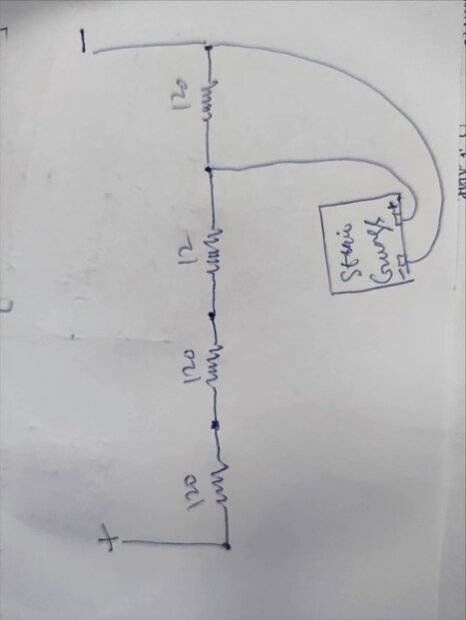

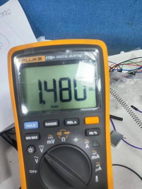

please can you check like this , before attaching strain guage , the DMM show zero but when i attach strain gauge ( replacing one resistor in brdige with guage) it show 1.480V while beam is stationary

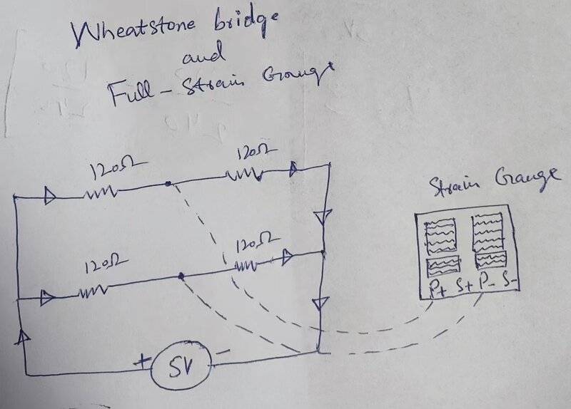

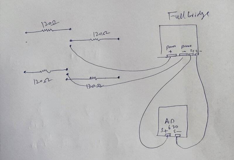

what does that diagram mean? Look at other schematic diagrams. You will notice that connecting wires are actually joined together (often with a dot). Those 120Ω reasistors are not joined to anything so they don't "do" anything. You should try to stick to the conventions if you want to make sense. Have you seen a diagram of a bridge circuit? The power connects across one diagonal and the meter connects across the other diagonal. Your picture shows none of this.
PS the way you actually connect things together and where the wires go is best shown by a conventional circuit diagram. Your breadboard version means nothing to anyone else but you.

What should I understand from that picture? We don't seem to be getting anywhere with this at the moment.
We are talking in English and that's because we can rely (at least to some extent) on understanding what we both mean. I cannot converse with you is you don't use the equivalent convention when drawing diagrams. There is a universal standard for drawing circuits. You need to use it. It is not difficult. Just look at text books and serious web pages.

please fine the attached conventional diagram
Ahh!! I see what's wrong. The four strain gauge resistors ARE the bridge. No external 120Ω resistors are needed. (This is a great example of where one should start with a proper diagram; it can save a lot of wasted time. :smile:

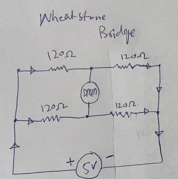

so should i make wheatstone bridge and connect this full strain bridge to it ? this is confusing that i should make a wheatstone bridge or not when these are full bridge strain gauge resistors
I thought you had got this. Why would you want another bridge when you have a strain gauge that IS a bridge? As the gauge flexes, resistors increase and decrease and the bridge becomes unbalanced proportionally with the strain. All you need is to reduce the supply volts to 1V by using the series resistor in the supply.
I suspect that you have not looked elsewhere to get an alternative view. there are dozens of web pages about the same problem. I cannot do the whole design job for. you.

yes sure , please can you check this reducing the voltage to 1V conventional diagram
You can check this yourself, actually. Show the workings of how you came to this circuit. What would the R1 be and what would the R2 be? The resistance of the bridge will affect how things work, remember.
