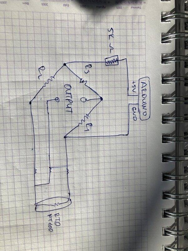

currently i working on RTD sensor using wheatstone bridge...but after i complete the circuit where Ra=Rb=Rc=100ohm wiith RTD pt100...i measure the resistance through multimeter...the value resistance is drop to 78 - 84 ohm..its normal?...or anyone has explanation..
i am also has a problem with RTD..where it cannot reach high resistance...i already test with water at 80*C(130.9ohm on datasheet)..but practically its not..it only can reach 120ohm (50*C)..

i don't think our meter is inaccurate..before i solder the smd resistance..i measure it..and its show 100ohm...after i connect into wheatstone bridge...i try to measure using multimeter on one of the resistance...its show 80ohm something...Voltage input is 5V..supply with voltage precision..should i lower the voltage supply again??
i m create bridge using pcb board with smd resistance..
i am using normal multimeter...yes it show 0ohm when the probe is connect together..

When you measure in circuit your meter shows resistance between its probes . The other three legs of your bridge will let some current pass which makes the total resistance between the probes smaller.

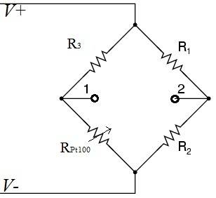

Is this your circuit, where R1 R2 and R3 are each 100 ohms??
How to analyze this :
Assuming there is no source connected to V+ and V- ,
Connect a meter across any leg of the bridge and you'll read:
(resistance of that leg ) in parallel with (sum of resistances of other three legs)
Do you know how to calculate resistances in parallel? It's too easy to believe, just remember this phrase: "Reciprocal of sum of reciprocals"
Example:
Connect your meter across RPt100 leg. If it's a DMM it probably applies one mlliamp of testing current and measures the voltage drop.
Meter will push its small testing current through RPt100 . Draw it on the above circuit perhaps in red.
But some of that test current will sneak around RPt100 through R3, R2, R1 loop. Draw that too, maybe in orange
So the meter will report the parallel resistance of those two paths.
Resistance of the RPt100 path is just RPt100 and that has reciprocal 1/RPt100
Resistance of the R1 R2 R3 path is (R1 + R2 + R3) which is 300 ohms and that has reciprocal 1/300
Let's just guess that RPt100 is 110 ohms at your workbench temperature, which has reciprocal 1/110 .
Now take your pocket calculator and add 1/110 to 1/300. That's the sum of the reciprocals. I get 0.0124242... What did you get ?
Take reciprocal of that, that's what the meter should read. I get 80.49 ohms . What did you get ? Is that about what you measured?
Remember , "Reciprocal of sum of reciprocals" .
Just too easy, isn't it? That 1/X key on pocket calculators is handy for resistances in parallel, 1/X then M+ ; M accumulates the sum of the reciprocals for you. MR and 1/X again, presto you're there.
You're not the first guy to get fooled by in-circuit versus out-of-circuit measurements.

What do you calculate your ohmmeter should read if you connect it across 1 to 2 in above bridge? Try it, what does it indicate ??

You have to paint an image in my brain(if i have one) . A word picture is okay , but an actual image usually replaces a thousand words.
Try right clicking that image in post #10, copy, then open Paint and paste it in. Draw in where you connect your meter and your power. Than save it someplace on your computer(i use a folder named PF) and put it up here by clicking UPLOAD button. It'll ask you where is that picture you just saved, just tell it.
Ohms law predicts 3.3 volts / 0.2 ma = 16,500 ohms. So I'm totally confused by what you have said about current. There's no resistors that high in your circuit unless you've burnt them open by applying overvoltage.

jim hardy said:
Well, I'm sorry but those words do not paint in my mind a picture of :
what is your circuit ?
what is a arduino 3.3v ?
from where and to where in your circuit does 0.2 ma flow ?
where does your 5V come from and where is it connected ?
from where to where does 0.4 ma flow while you are using 5V ?When you connect what directly to the bridge ?
What on the pcb gets hot ?
I don't mean to be harsh, and i know English is probably not your first language .
That you are able to communicate at all in a second language places you ahead of me.
But a question well stated is half answered.
Ohms law predicts 3.3 volts / 0.2 ma = 16,500 ohms. So I'm totally confused by what you have said about current. There's no resistors that high in your circuit unless you've burnt them open by applying overvoltage.And your meter indicated 0.2 ma? Was it set to DC milliamps , or AC ? What range?

i m sorry for my poor explanation. I m still new to this forum interface.. i m not sure whether i upload it or not.
Arduino UNO is one of the most easiest learning microcontroller and its open-source code( meaning your code can be sharing). There are 3.3V and 5V pin from Arduino UNO board. I m try to find out what is the output current from Arduino UNO board through internet, but i could not verify it. So that why, i am using multimeter to identify the output current.
There are two ways i measure current, first series with bridge (Untitled.png) and the other way, directly from 3.3V or 5V to GND pin of microcontroller(Current_reading.)..for 3.3V the current output is 0.2mA while 5V the current output is 0.4mA.
is it correct the way i am taking the current measurement??

The first measurement should show around 33 mA, unless there's a resistor you didn't show.
The second measurement will, with great probability, destroy the Arduino. You can measure voltage this way but never current.
If you measure the voltage, does it still show 3.3V ?

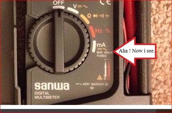

i have only one DMM and i m sure fuse is not broken yet.
i m using this kind of DMM. the proble is attached to the DMM

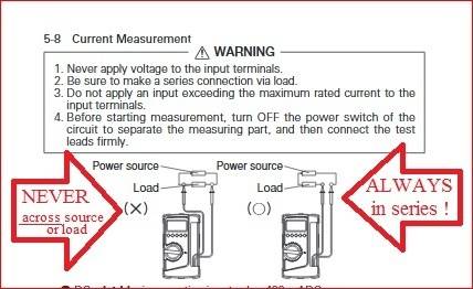

Well , I'm not sure.
Since you said you've violated this warning in your meter's instruction manual, specifically number 2,
http://www.sanwa-meter.co.jp/prg_data/goods/img/PH41381900473.pdf (Red added by me - jh)

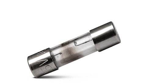

Don't you think it would be wise to take a look at the fuse ?
Do you think that black vaporized metal deposited inside the glass tube might conduct just a trickle of current between the ends?
Are you are seeing just a trickle of current ?
Pull your fuse and measure it with the ohms scale. I bet you see about ten thousand ohms.
Whatever you see it'll resolve any question as to condition of your fuse.
That's how you troubleshoot, eliminate possibilities one at a time.
There's a big difference between "I'm sure" and "I verified by test" .
And you're far from alone in blowing multimeter fuses. I keep a pack of ten on hand.
That's the reason better multimeters make you move a wire before you can measure current. It's too easy to roll that knob around into milliamps position.
That's why it's the very last one, to avoid getting there by accident.

since you said that and show the warning in the manual...i already checked and verified it.
the fuse already blow but the DMM still work i guess except for the current measurement. i check the continuity of fuse since the fuse body not in transparent glass using same DMM.

Hi everyone. I'm setting this project so i need some help. I read all comments and I have a question. If i choose R3 and R1 to 5000 ohms and R2 is 100 ohm. Thus 5V / (5000+100) = 0.98 mA so Arduino will fine and Multimeter don't blow up i think.
That would be safe.
However: You WILL have to calibrate the whole circuit. Please consider the tolerance of those 5000 Ohm resistors and what values may have and still be within tolerance. Even with 1% resistors one could be 5050Ω and the other 4950Ω. That could put the bridge out of balance by the total resistance of the PTD!
For the majority of uses/designs, the "best" design/operation of a bridge circuit is when all the resistors are the same value. Then in your case, you would put another resistor in series with the supply voltage to keep the current down in the bridge.
Here are some excerpts from Post #10 above:
jim hardy said:
We always use something to set current through a Wheatstone bridge . Simplest is just a resistor in series with supply.
With Pt sensors I like to set for one milliamp in each leg at balance.
That's because one milliamp will not heat your sensor above ambient temperature.
One milliamp through a 200 ohm bridge leg would be 200 millivolts , 0.2 volts, across your bridge.
That means your series resistor needs to drop the 5 volt supply by 4.8 volts.
4.8 volts / 2 milliamps = 2400 ohms.
Add a 2400 ohm resistor in series with your supply and you'll have a high quality temperature measurement instrument.
Old Jim :oldcry:
Tom.G said:
That would be safe.
Here are some excerpts from Post #10 above:Cheers,
Tom
You mean like this?
