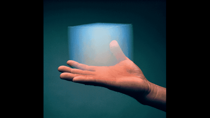

In what solids class would you put Aerogel?
Photo of an open palm holding a glowing translucent blue cube, lit from within against a dark teal background, illustrating a solid-looking block of a pale, cloudy material.
I do not think we have adequately defined them, but to me it is a porous solid which I would describe as a gas-solid mixture with specific properties (which I will not list here).
