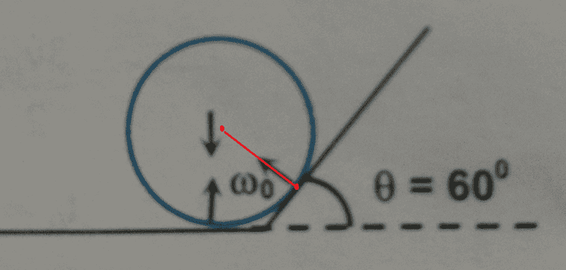

A uniform solid sphere of radius R, rolling without sliding on a horizontal surface with an angular velocity ωo, meets a rough inclined plane of inclination θ=60°. The sphere starts pure rolling up the plane with an angular velocity ω. Find the value of ω.
Conservation of angular momentum.
If we conserve angular momentum about the point of contact with inclined plane, what will be the equation that we will get. I am confused as to what velocity will we take as the initial velocity of the centre of mass about the point of contact with the incline.

Equation for conservation of angular momentum is given in my solution as:
2/5mR2ωo+mvoRcos60°=7/5mR2ω.
I understand that the first term on the lhs is the angular momentum due to rotation where is the second term in the lhs is that's due to the centre of mass but I am not understanding why we have taken it mvoRcos60°.

How far does the original line of motion of the mass centre pass from the point you are taking moments about?
In this picture, are the two points (COM and point of contact of incline and sphere) correctly marked? If so, then the distance should be R, right? And if we calculate angular momentum of the mass center about the point of contact, then it will be R(vector)×mVcm(vector), which will be mRVsinα, where α is the angle between R and Vcm vectors, which should be 120°?
So sorry, the angle between R and vcm vectors will be 150° and therefore angular momentum is mvrcos60°.
What do you plan to do next? The way I looked at it, the sphere initially had components of velocity normal to and tangential to the slope. As it didn't bounce, the normal component was lost in a totally inelastic collision, leaving just the tangential component, which is ##v \cos \theta##.

Why will the normal component of initial velocity of the sphere make it leave the surface of incline when it is acting downwards wrt the incline?
Btw I used conservation of angular momentum and got the equation as:
Iwo+mvo Rcos60 = Iw+mRv.
w and v are final angular and linear velocities respectively(just after it starts moving on the incline). v=Rw. And therefore w can be calculated in terms of wo.

We have a rotating ball striking a surface at an angle. In reality, we would expect it to bounce a little, but for the purposes of the question we take it as completely inelastic.
Anyway, you now have the two terms making up the initial angular momentum about the impact point, matching the left hand side of your equation in post #4. Are you ok with the term on the right hand side?
Yeah, I just edited my last post. Thanks
Good.
