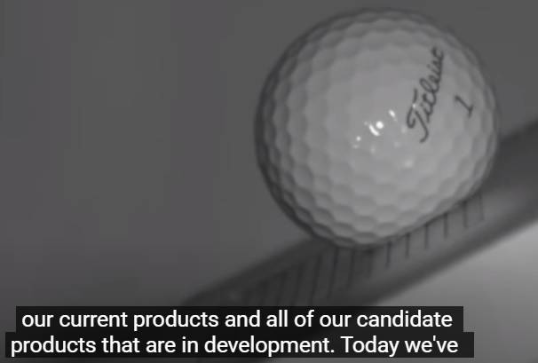

I once had a need to calculate the force between two colliding objects. A part that should have had near infinite life was failing in a short time. An elastic collision can be approximately modeled as a collision with a spring in the middle. If you know the mass and velocity of the moving object, the spring constant of the spring, and assume zero damping, it is easy to calculate the peak collision force.
The challenge is to find the spring constant at the impact. We did it by using high speed video at 20,000 frames per second to measure the duration of impact. The math is as follows:
1) The "spring" compresses for half the total duration of impact, then pushes the object back for the second half duration.
2) Since we are assuming that the impact is modeled using a linear spring, the average velocity during the deceleration portion (first half) of the impact is half the approach velocity. Average velocity times duration of the deceleration portion equals deceleration distance.
3) The kinetic energy of the object is converted to potential energy in the spring: ##KE = 0.5Kx^2##, where##K## is the spring constant and ##x## is the deceleration distance. The only unknown is ##K##, so solve for ##K##.
4) Knowing the spring constant ##K## from (3) above, and the deceleration distance from (2) above, the peak force is ##Kx##.
In the real world, elastic impacts are not linear springs, but this gives you a way to estimate the peak force. You may be able to find a YouTube high speed video of a similar object. For example, here is a screen grab from a Titleist high speed video of a club hitting a golf ball:
The peak deflection of the golf ball can be estimated from the video, and the velocity might be given in the video. If not, the velocity can be measured from the video because you know the diameter of the ball.
Another data point is that a steel ball peen hammer hitting a heavy piece of steel has in impact duration of about 0.001 seconds. And we found why that part failed.
