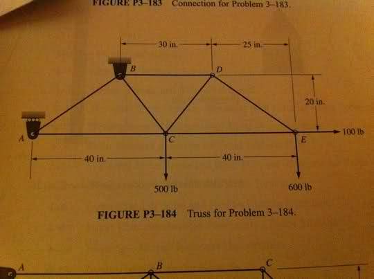

Determine force of each member using joint method
T = F x D
Answers are:
Fab 2465 T
Fbd 1200 T
Fbc 1375 C
Fdc 750 C
Fde 860 T (This one is what I tried)
Fce 649 C
Fac 1922 C
Thanks.
T = F x D
Answers are:
Fab 2465 T
Fbd 1200 T
Fbc 1375 C
Fdc 750 C
Fce 649 C
Fac 1922 C
Thanks.
You have the wrong geometry for the slope of member DE...the rise is 20 but the run is 25, not 55...
Always determine joint support reactions first using the equilibrium equations; then start at the easiest joints next when determining forces using the method of joints. Also be sure to indicate T (force of member on joint pulls away from joint) or C (force of member on joint pushes toward joint).
