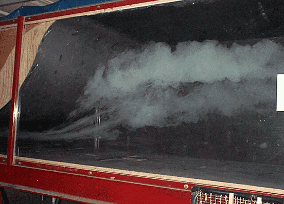

I imagine that there must be studies, perhaps even wind tunnel results of a blunt object in a moving stream of air (like in the picture). The streamlines are indicative of air movement normal to the motion. I don't have any such studies, but other PF members may.
246385
But Dave's comment might be more relevant than the OP's question.
