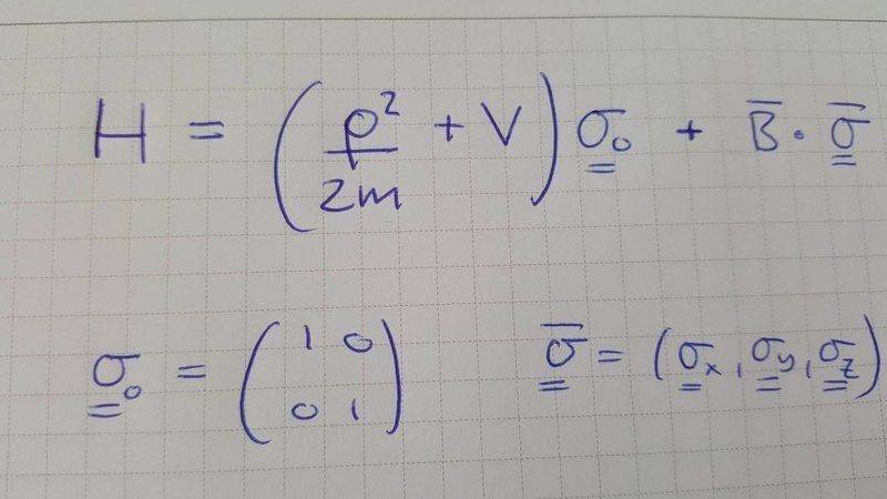

Recently I have been asked to solve the problem of an electron in a Zeeman-field that couples the spin of the electron to the magnetic field.
I am not sure how to correctly set up the problem. I think, however, that what I have done on the picture is correct. The usual p^2/2m + V term in the Hamiltonian is tensored with the identity matrix and the Zeeman term is added in the usual way.
I am however unsure how to solve this Hamiltonian. How do you solve something like this with both an eigenvalue equation in the matrix structure and in the spatial part of H?
  • Handwritten equations on grid paper: H = (p^2/2m + V) sigma_0 + B · sigma, with sigma_0 the 2x2 identity matrix and sigma the vector of Pauli matrices sigma_x, sigma_y, sigma_z.

Okay but is it not possible to find the exact analytical expression for the eigenenergies?
Easy. Just find a unitary transformation which rotates B in the direction of the z axis. Then the hamiltonian will be diagonal as only the sigma_z component remains.

This diagonalizes the interaction Hamiltonian, but not the full Hamiltonian.
If B is constant, it does, at least in spin space.
