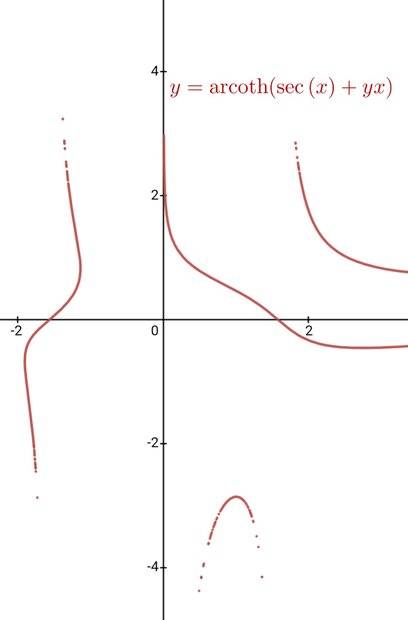

How do you evaluate the area bound by an implicit curve when you can't rearrange for either variable or convert to a polar equation?
The implicit curve in question is ##y=\operatorname{arccoth}\left(\sec\left(x\right)+xy\right)##; a portion of the equations graph can be seen below:
In particular, I'm interested in the area bound by the curve, the ##x##-axis and the ##y##-axis. As such, we can restrict the domain to ##[0, \frac{\pi}{2}]## and the range to ##[0,\infty)##
From what I can tell, there's no way to solve this equation for either ##y## or ##x##, so standard integration is out of the system. My next thought was to convert it to a poloar equation, which got me ##r\sin\left(\theta\right)=\operatorname{arccoth}\left(\sec\left(r\cos\left(\theta\right)\right)+r^{2}\cos\left(\theta\right)\sin\left(\theta\right)\right)##. However, this has the same issue of not being able to solve the equation for ##r##. After this, I did some Googling and I managed to find some reference to double integral methods on Maths Stack Exchange (the reference I used can be found here; in the answer that was marked as correct). However, I found the whole thing quite confusing and I'm not very confident I did it correctly. Regardless, I made an attempt: Firstly, I defined ##f(x,y)## like so:

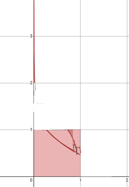

Thank you for the reply, it helped a lot. I've amended the errors in the domain on the piecewise and on the integration bounds, so now I have:
$$f(x,y)=
\begin{cases}
1 & \text{if }\operatorname{arccoth}\left(\sec\left(x\right)+xy\right)>y \\
0 & \text{otherwise} \\
\end{cases}
$$\int_{0}^{\infty}\int_{0}^{\frac{\pi}{2}}f\left(x,y\right)dx \text{ }dy \approx 1.02554446649$$
So now the result of the double integral should at least be more accurate. To check if it's even remotely feasible, I took the graph I had and manually "cut" sections off to fit it all in the square like so:
So it is looking fairly accurate from what I can tell. The darker shaded areas are effectively "double ups." Based of the estimation in the picture, the actual area under the graph seems to be slightly larger than the estimation from the double integral (probably in the 1.05 to 1.15 range), but we already knew that the double integral method was likely yo have a fairly substantial margin for error.
As for the missing point at ##x=\frac{\pi}{2}##, I don't believe it to be an issue due to the fact that the arccoth function still outputs a result of ##0## even for undefined values such as ##\sec{(\frac{\pi}{2})}## (I verified this using WolframAlpha).
As for the python code; I really do appreciate it but unfortunately I'm really not well versed in any proper coding like Pyhton (I can barely get Latex to work on sites like this 99% of the time). Would there be any other way to get a more accurate answer than the double integral via something like Desmos or Wolframalpha?
