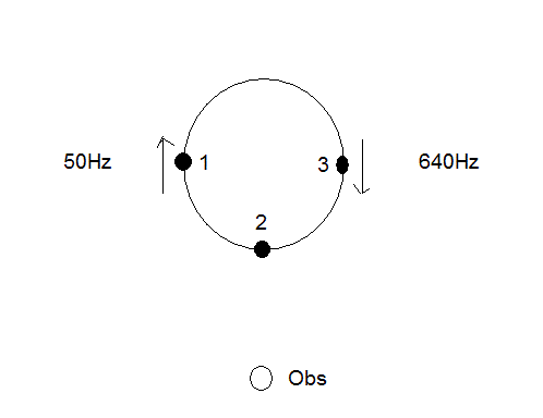

my maths is shockingly bad... it helps to draw pic's
Diagram of a circular path with a source at three marked points: point 1 on the left with an upward arrow and 50Hz, point 2 at the bottom, point 3 on the right with a downward arrow and 640Hz, and an observer shown as an open circle below.
the Vsource at points 1 and 3 are constant just have + or - values
For an instant of time at point 2 that forward/reverse velocity relative to the observer is zero
and at that point Fo is heard
with the velocity being constant, I would expect the Fo at point 2 to be half way between 50 and 640 ?
some one please correct me if I am wrong.
if so you now have Fo and can work out the Vs at points 1 and 3 which = the overall Vs of the spinning sourceDave

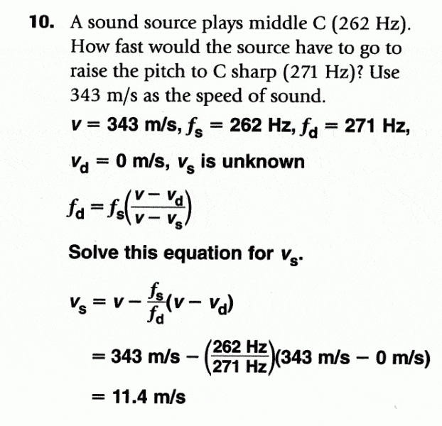

here's an example graphic I took out of a physics paper that showed the rearranged formula to solve for Vs
Worked solution to problem 10: a sound source at 262 Hz must rise to 271 Hz, with v = 343 m/s and v_d = 0 m/s; solving fd = fs(v - vd)/(v - vs) for vs gives vs = 11.4 m/s.

we can only go on the observed sound freq's given in the problem ( they may or may not be realistic) its irrelevant, we both were able to come up with a correct solvable answer :)
