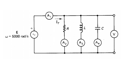

A1 = 5A, A2 = 4A, A3 = 3A. V = 120V
a) Given the circuit above, find A4
b) Find the angle between E and IT. Draw a diagrammatic (?) and find the power in the circuit.
c) Find the values of R, L and C.
a)
IT is 5A.
R has 120V across it, and 4A through it. Therefore ZR = 30Ω∠0°
L has 120V across it, and 3A through it. Therefore ZL = 40Ω∠90°
C has 120V across it, and xA through it.
I'm not sure how to proceed here. Can I use admittance, somehow?

The phasor for the current through the resistor lies on the real axis of the complex plane. That of the inductor lies along the negative imaginary axis, and that for the capacitor along the positive imaginary axis. That is to say, if we were to assign current phasors you'd have
##I_2 = A_2##
##I_3 = -jA_3##
##I_4 = jA_4##
Now, A1 is the magnitude of the total current phasor. Can you write an expression for the magnitude of the total current in terms of the current phasors? Can you solve for A4?

So what I've done is 5A = 4A - j3A + jxA
jxA = 1A + j3A which is 3.16A at 71.57°
I know this doesn't make any sense at all. The real part should be 0.

A4 is not the total current. A4 is the capacitor current. What is the expression for the magnitude of the total current A1?
A1 = A2 + A3 + A4, I would assume.

A2 and A3 do not add up to A1. A2 and A3 and A4, taking into account their phase angles, add up to A1 if you are talking about phasor magnitudes. Treat them like complex numbers and add them accordingly.
gneill said:
One is real the other two imaginary. In sum there is a total real value and a total imaginary value. The magnitude of the whole is what you are looking for.
So 4 is the total, and only, real part. Since I1, the total current, is 5, the only imaginary part that satisfy that "equation" is 3. Therefore it has to be +3 or -3.
The known imaginary part is -3. Therefore the imaginary part of A4 has to be 0 or +6.
Am I making sense here?
Yup.

For my b) problem: Find the angle between E and IT. Draw a diagrammatic (?) and find the power in the circuit.
The angle of E is 0°. I'm just assuming this. Is E "always" said to be 0° because phase angle is relative?
The angle of IT is 4A \frac{+}{-} j 3A
IT = 5A \frac{+}{-}∠36.87°
The phase angle between E and IT is therefore \frac{+}{-}∠36.87°
For the diagrammatic (is this the correct term?), I've drawn the attached picture below. Is this correct? It shows that the current is at the phase angle I found above - assuming that is correct. I don't see any usefulness for the drawing, however.
Is there any way I can use it to find the power in the circuit?

You've drawn a diagram showing the source voltage phasor and (once you've decided on a single phase angle) the current phasor. I suppose that the real power might be found as the dot product of the current vector with the voltage vector. Maybe your book or class notes have some other suggestion?
Another possibility is that they want you to draw the current triangle showing the magnitude of the current on the hypotenuse and the real and imaginary currents as the legs of the right triangle. Scale the sides by E (essentially multiplying current by voltage) to turn it into a power triangle.
Usually I just take the complex product P = EI*, where I* is the complex conjugate of the current. This yields P as the complex power, giving you both the real and imaginary parts of the power in one operation.

Thank you. The magnitude of the power is 600W right? 120V * 5A. The complex conjugate will change the phase angle from + to - or - to +.
Mutaja said:
I assumed it can be 2, therefore I made two calculations (putting them into one). One if the current through the capacitor is 0, and one if the current through the capacitor is 6A.
Ah. You might want to make that more obvious in the work that you hand in. And perhaps use different colors for the two solution vectors.
That would be the Apparent power, not to be confused with the Real power or the Reactive power. Only Real power is actually consumed by the load (turned into work or heat).

Yes, of course, the power triangle. The calculations I've done with the real power has always been with given resistance. Earlier I found the resistance to be 30Ω
Will the real power in the circuit then be P = I2 * R = 52A * 30Ω = 750W?
The total current is a complex value with magnitude 5. The real part of the total impedance won't be R but rather the real component of the total impedance (something closer to 20 Ω --- you can calculate a more accurate value). The real power will depend upon the phase angle of the current with respect to the voltage, and is in fact the basis of what is called the power factor which is the cosine of the phase angle.
As an alternative, knowing that the resistor is the only component that will dissipate real power you might choose an alternative formula for calculation power that takes advantage of the known voltage across the resistor or the given current magnitude that flows through the resistor (A2).
Lets go with the easier suggestion first.
The voltage is 120V, the current is 4A at 0° thus the power will be 480W?
Can the power have an angle? I would assume yes, the combined angle of the current and voltage, depending on the magnitude of the two?
In this case, both the voltage and current is at 0° therefore, the power will be at 0°?
Yup. That's the real power that the circuit dissipates.

Okay, can you try one more? Take the total circuit current I (the sum of all branch currents) in complex form and calculate EI*.
I can always try.
ITotal = I2 + I3 + I4
= (4A + j0A) + (0A - j3A) + (0A + j6A)
= 4A + j3A
= 5A ∠36.87°
The complex conjugate of 4A + j3A is 4A - j3A, thus the total current will be 5A ∠-36.87°
P = EI* = (120V + j0V) * (4A - j3A) = 480W - j360W = 600W ∠-36.87°
Is that the apparent power, as you mentioned earlier? That's my first thought at least. My second thought (ironically) is that I've done it all wrong.

You've done splendidly. That P is the complex power phasor, its magnitude (600 VA) is the apparent power. It's components are the real power (480W) and the reactive power (360 VAR). Note the unit variations that are used for each. They are used to distinguish between the apparent, real, and reactive values when presented, although they are all equivalent to Joules/second in the final analysis.
Well then, I've gained a greater understanding of the power triangle and how it works. The word power magically triggers the watt unit in my brain, unfortunately, but I will most certainly keep that in mind.
The last problem is pretty straight forward. If I get any trouble I'll post here. If not, I'll take a short break and start my next problem.
Thanks for taking your time. Really.
