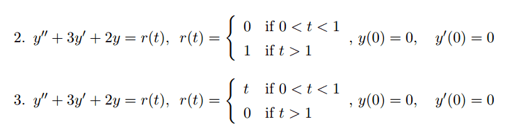

Consider the following problems
Two piecewise definitions of r(t) with ODE y'' + 3y' + 2y = r(t) and y(0) = 0, y'(0) = 0: problem 2 gives r(t) = 0 for 0 < t < 1 and 1 for t > 1; problem 3 gives r(t) = t for 0 < t < 1 and 0 for t > 1.
In #2, they start the solution by saying: r(t)=u(t-1)
in #3, they start by saying that r(t)=t-tu(t-1)
I understand how to solve the problem once you get r(t), I just don't understand how they decide what r(t) is going to be.

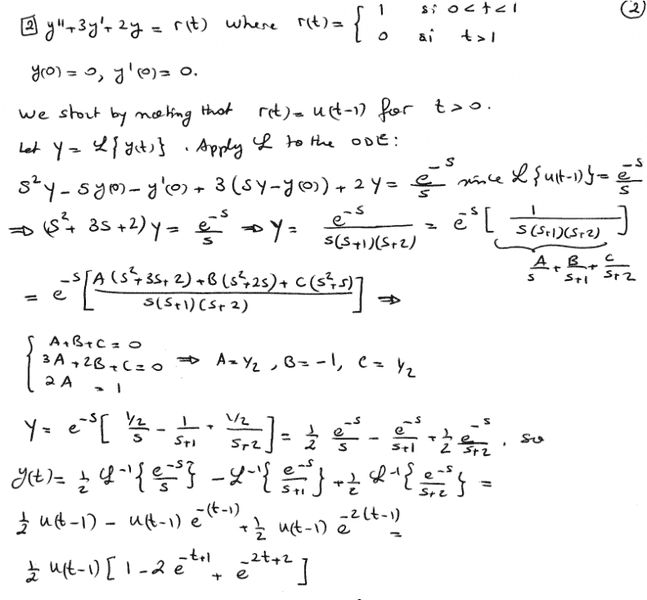

Here is the solution for #2:
Handwritten solution to an ODE y'' + 3y' + 2y = r(t) with a piecewise r(t), using Laplace transforms, partial fractions and the step function u(t-1), ending with y(t) = (1/2)u(t-1)[1 - 2e^(-(t-1)) + e^(-2(t-1))].
If they would have chose a different r(t) at the very start, they would have gotten an answer (since we take the laplace and use it to solve the problem). My question is how would I know to say r(t)=u(t-1) in this case, where as for #3 they do:

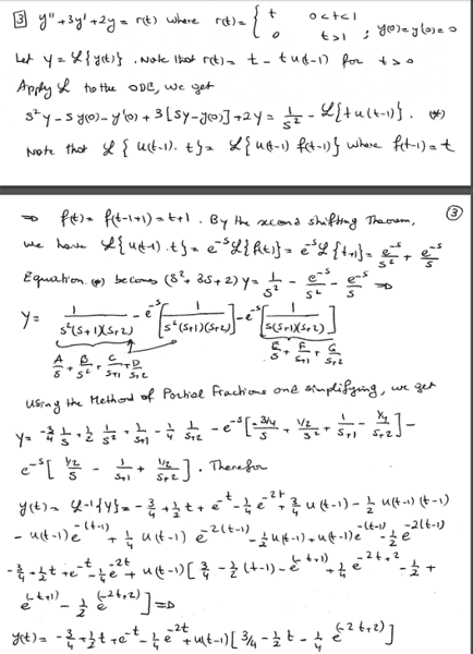

Handwritten worked solution of a second-order ODE y'' + 3y' + 2y = r(t) using Laplace transforms, with r(t) piecewise defined and step functions u(t-1) and partial fraction decomposition steps.
taking r(t)=t-tu(t-1)

You do not need to write ##r(t)## in terms of ##u(t-1)##; you can just integrate directly, to find
$$ ({\cal L}\,r)(s) = \int_0^{\infty} e^{-st} r(t) \, dt = \int_1^{\infty} e^{-st} r(t) \, dt,$$
because in both cases we have ##r(t) = 0 ## when ##0 < t < 1##.
Without having looked at your working, it just seems to me unnecessarily complicated just from the length of it.
When you have the = 0 condition you have just got a common or garden homogeneous lde, with an easily factorable differential operator if you want to look at it that way.
When you have the = 1 condition, it is just the same homogeneous lde if you make a new variable, Y say, Y = (y - 1) .
Is that right?
If so then it's usually not such a long calculation so if you're finding it any more complicated than this then if I were you I would do it again simpler and see if its checks with what you have done.
Maybe in problems like this you just have to look and see sometimes the variable in the solution might reach a a point where equation changes.
